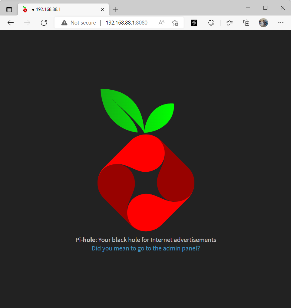

Basically you need to forward ports to your internal “docker” veth interface. Not an expert but for example I forwarded my pihole to 8080 using this rule on this page (https://help.mikrotik.com/docs/display/ROS/Container)
Forward ports to internal Docker
Ports can be forwarded using dst-nat (where 192.168.88.1 routers IP address):
add action=dst-nat chain=dstnat dst-address=192.168.88.1 dst-port=8080 protocol=tcp to-addresses=172.26.0.2 to-ports=80
And I can access it on my network through this:

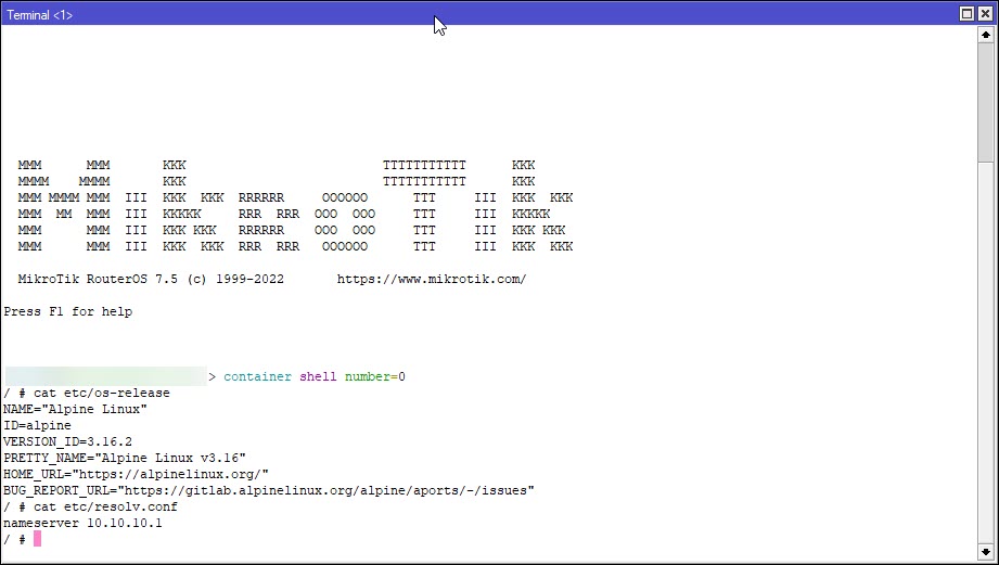

Would you please explain a little bit in details? I’m using the similar configuration. I added a veth and configure it with my LAN ip and gateway (10.10.10.3/34 and 10.10.10.1), then I added this veth into my bridge that has other LAN ports. After installing the adguard with the veth, the adguard can access internet without no problem. However, I cannot ping from the machine (10.10.10.100) in my LAN to the veth (10.10.10.3), and vice versa. Any advice? Thanks!
