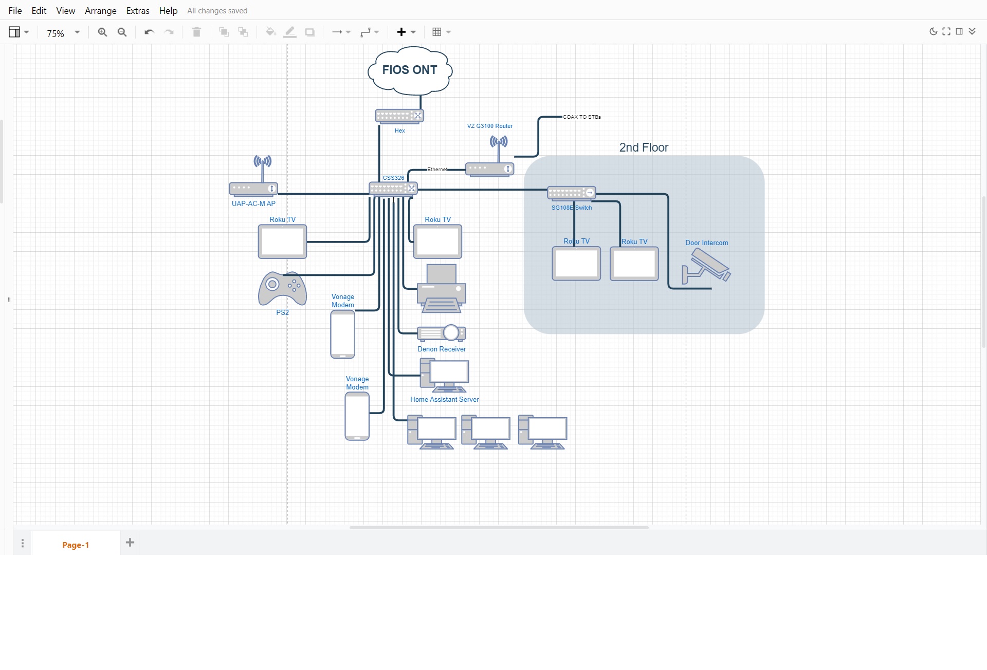

I have FIOS ONT that has Coax for TV and twister-pair/ethernet for data.
The Verizon router (G3100) needs to have both a coax connection (to communicate data (TV guide/listing/etc.) to the TVs and an ethernet connection to the Internet.
The ONT is connected to a hex via ethernet. The hex to a CSS326.
On the network are a bunch of cable boxes (getting IP addresses via DHCP from the G3100), a bunch of TV, a AV receiver, Roku boxes, printers, doorbell (Comelit), a Home Assistant server, a couple of Windows workstations, a Unifi AUP-AC AP, Xbox, Playstation, 2 vonage modems.

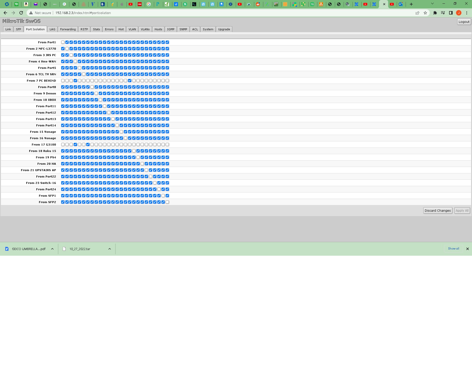

There is no VLAN set up, and I’m just now playing with port isolation making the G3100 able to communicate solely with the port on the switch that the hex is on.

The G3100 is the Verizon router. It provides data (such as TV listings) to the set top boxes. It connects using TCP/IP to the STBs via coax. It needs to have Internet access to get the data needed by the STBs, and therefore has an ethernet connection on one of its switch ports (not a WAN port). I gave it a static IP of 192.168.2.1 (for the LAN or switch side).
It does not need to be on the same subnet, nor does it need any communication with any other device on my LAN (except for management purposes which would be nice). It only needs Internet access.

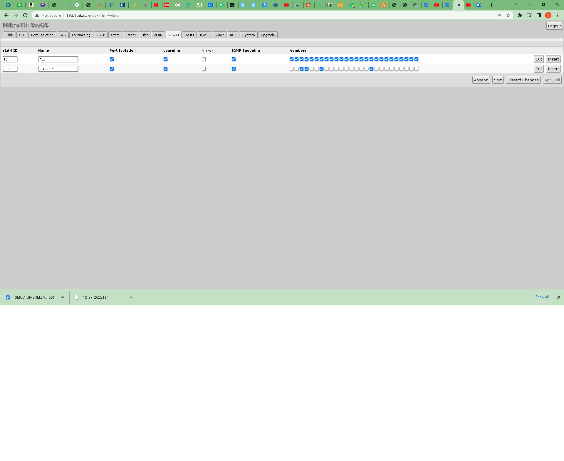

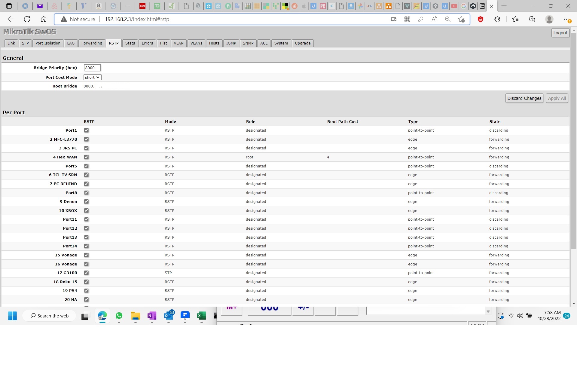

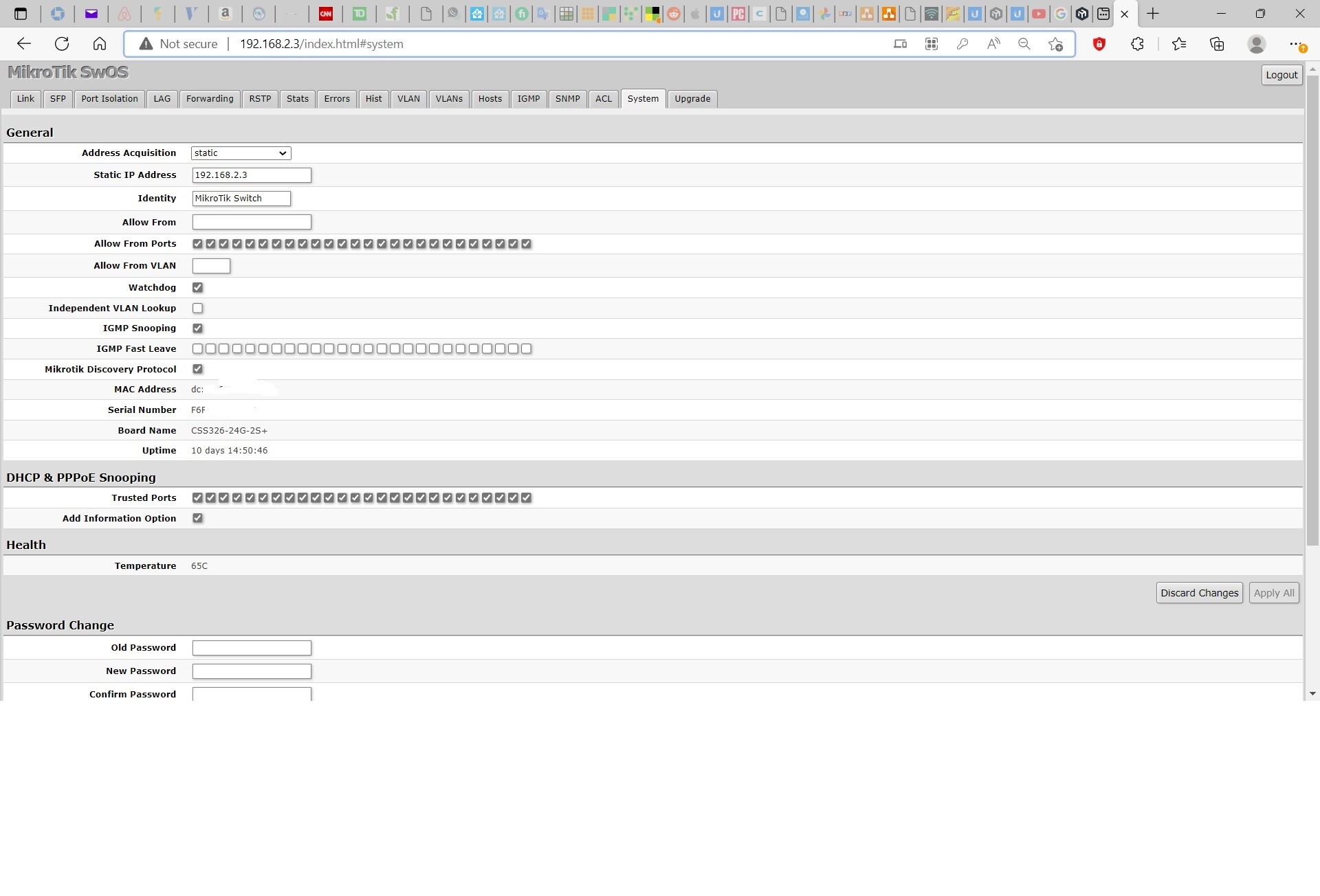

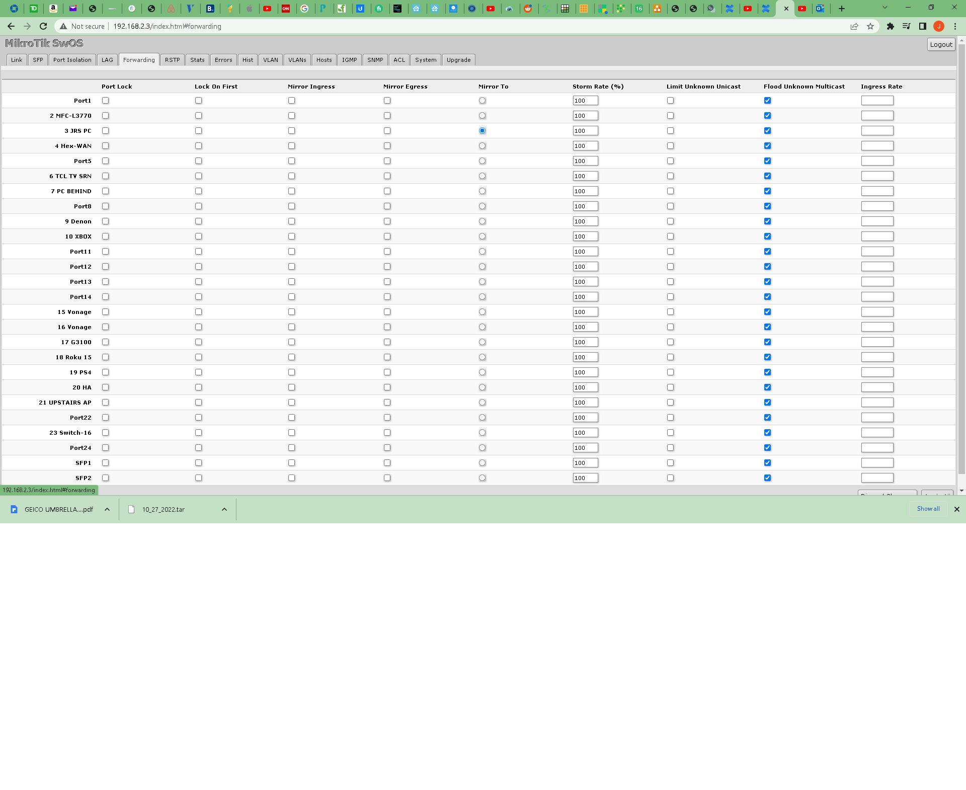

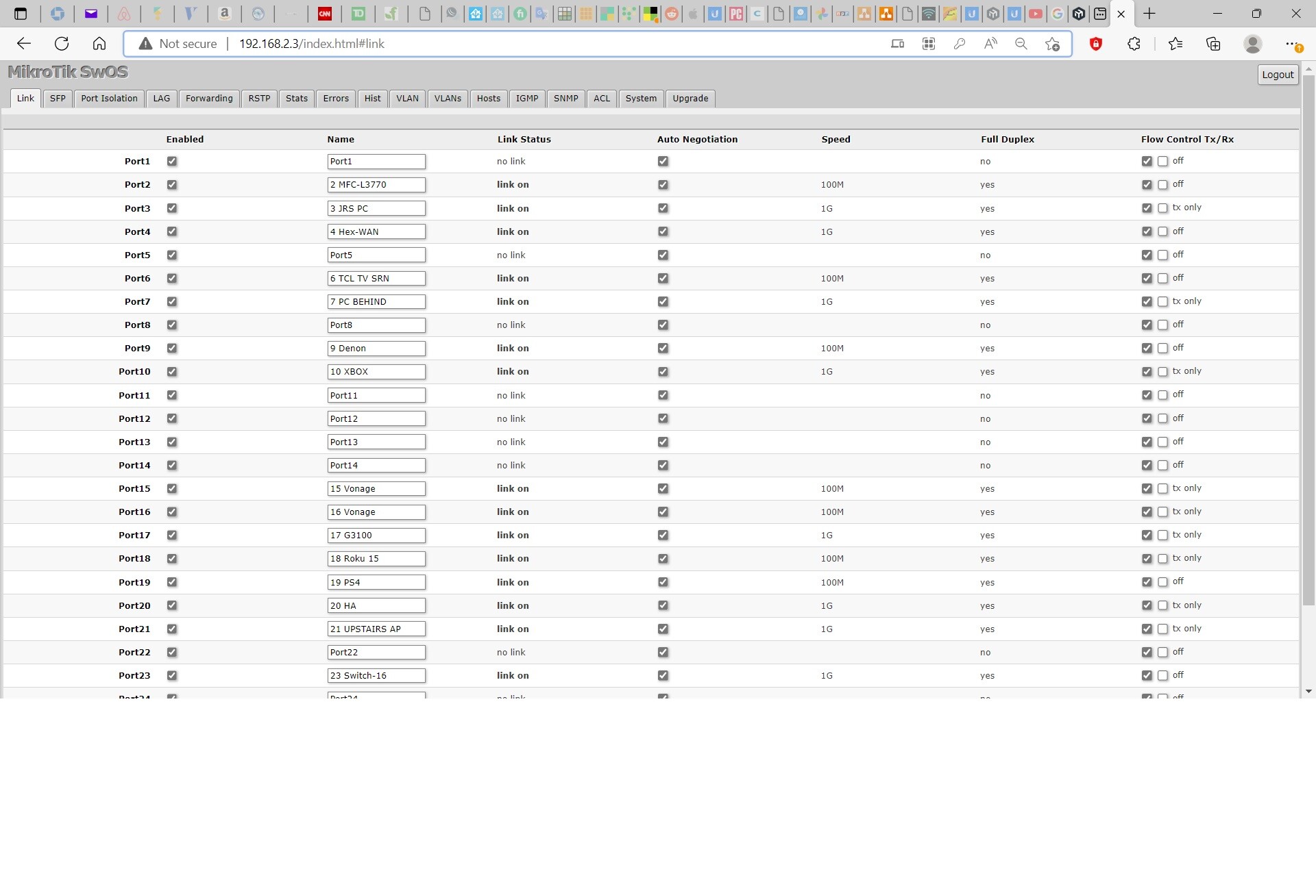

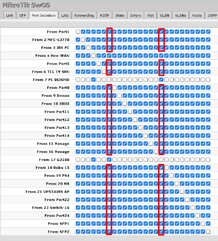

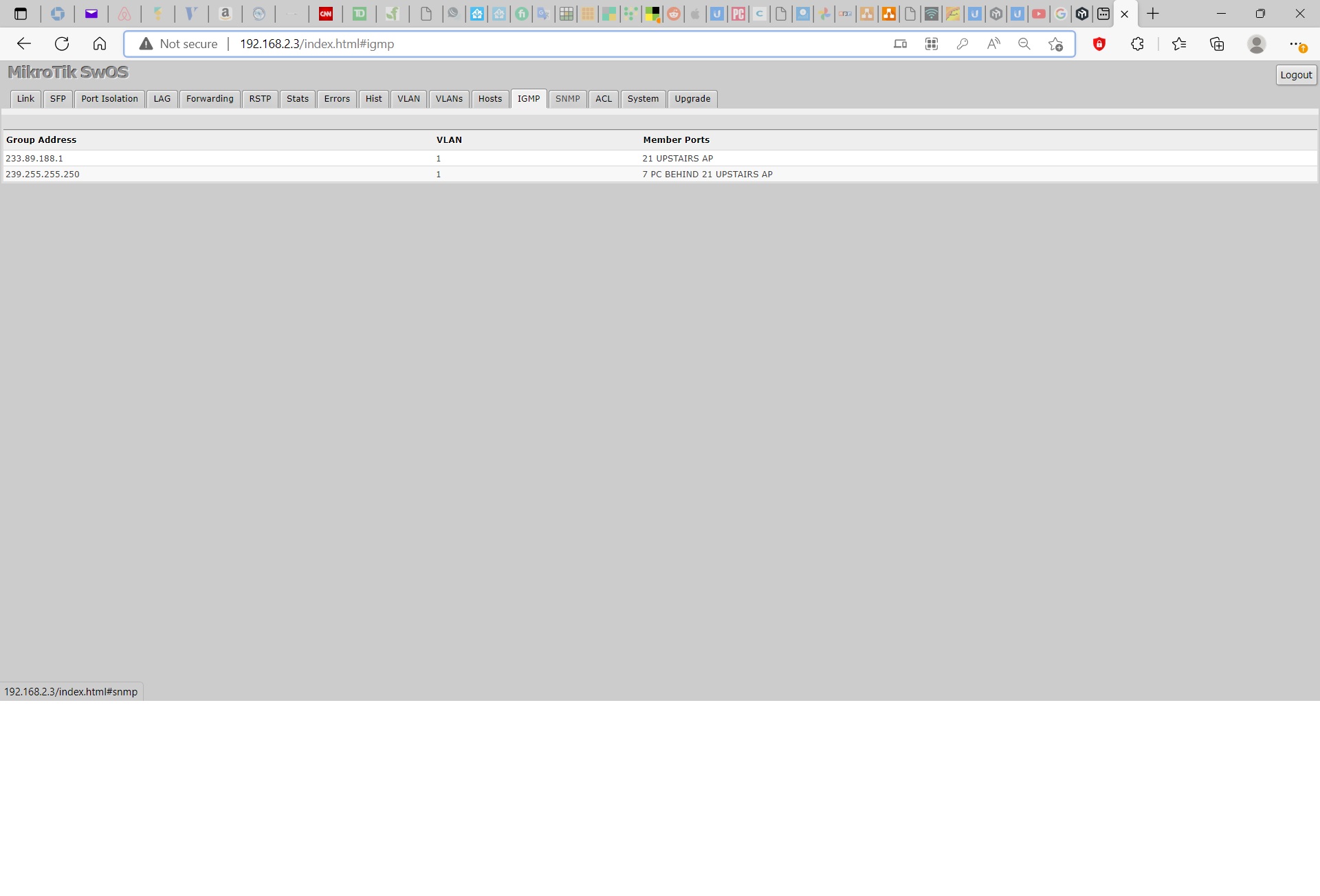

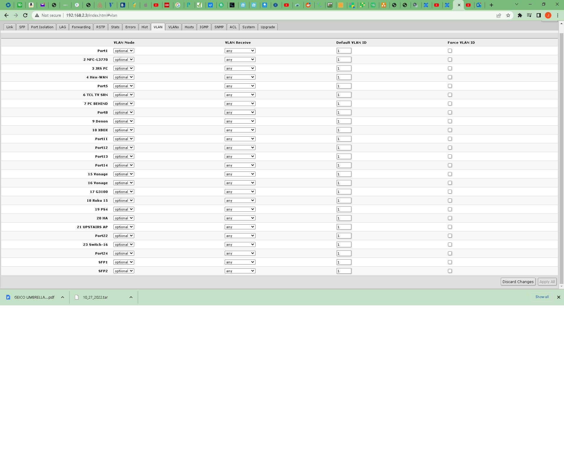

I attach the hex export and various CSS326 screen shots, as well as a current diagram.

Please upload current screenshots from the CSS326 VLAN, VLANS, Forwarding, and Port Isolation Tabs
Because port isolation should limit what ports a broadcast sent from a device connected to a port can send to.

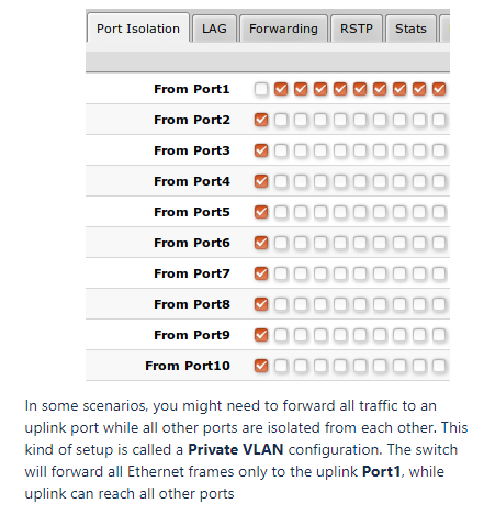

E.g. for the example in this port isolation, if you look at the middle example (copied below for easy reference), if a device connected to port 2 sends a broadcast (e.g. ARP, DHCP discover, etc.) the only other port to receive the broadcast will be port 1. If port 1 sends a broadcast then all other ports will receive it (assuming in the same vlan). I don’t like MikroTiks use of the term “Private VLAN” because this is not the same as what Cisco RFC 5517 Private VLAN is. (rfc5517 pvlan uses 802.1Q tags but is proprietary and can cause issues if used in networks with non cisco switches, rfc5517 is not a standard it is a “FYI”) It is similar to the difference between RSTP and the TP-Link SG108E “loop prevention”, both are meant to prevent loops, but the SG108E uses a simplified (proprietary) way that you have no settings to affect which redundant link will be disabled.
With the number of devices you have, unless there is a malicious device, broadcast traffic should not be a problem. You also have IGMP which should limit multicast traffic. If you look at the statistics tab on your CSS326, you should be able to see how much broadcast and multicast traffic there is on each port. On my CSS106 the stats tab has everything that is on the stats and Hist. tabs on the CSS326, because it has only 6 ports (5 RJ45 and 1 SFP) and the stats/histogram are in colum format, where on the CSS326 if is one port per row.
The point being, security is a much more meaningful goal than reduction of ethernet packet flooding is.
I set up a Win10 PC running Winshark connected to port 7 of the CSS326. The isolation settings allow traffic between the Winsharp Win10 PC on port 7 and the G3100 on port 17 and the hex on port 4. I very well may be wrong about the traffic captured.
I have included screenshots of VLAN, VLANS, PORT ISOLATION, FORWARDING AND STATISTICS.
I’ve had the port isolation enabled for the G3100 for close to a couple of days.
Thank you for clarifying that I shouldn’t have any concerns with packet flooding and that port isolation means no broadcast traffic pass between isolated ports.
You have only half of the “port isolation” done. The “rows” specify what ports can be sent to. Therefore the columns represent what ports data can be received from. If you want 4 and 17 to be isolated from other ports, then you need to prevent the other ports from sending to 7 and 17. The “matrix” in default state has all enabled except for the diagonal, because ports should not forward to themselves.
My guess is the broadcast traffic you were seeing was not from a mac address behind port 7 or port 17. You can see the “learned” mac addresses by looking at the output of the hosts tab, and look for all mac addresses associated with ports 7 and 17. My guess is that there will only be two, the PC on port 7 and the mac address of the GS3100. In wireshark you an add a column with the source mac address (remember from Ed’s fundamentals, that mac addresses have significance only on the local LAN segment. So any traffic from the internet will have the hex’s mac address associated with the bridge.
For example if you clear all the boxes outlined in red, then 4, 7 and 17 will be able to communicate with each other, but 7 and 17 will only be able to communicate with each other and the hex. The hex can still talk to all the other ports.
If you are interested in seeing traffic for a specific port, the proper place to plug in the PC running wireshark would be the “designated mirror port”. Then you can tell the switch what traffic (ingress or egress from set of selected ports). Looking at your “forwarding” tab screen, you can see you have port 3 selected as mirror, and nothing is being copied.
Thank you so much for the explanation of the rows and columns in port isolation. I get it now and have configured it as needed.
