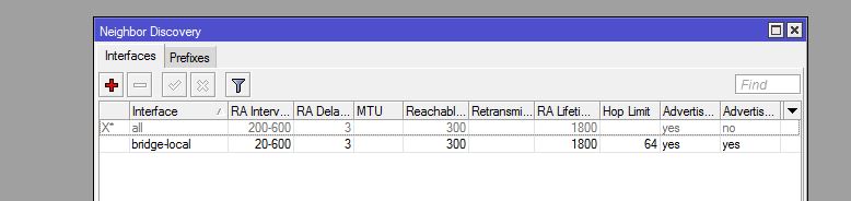

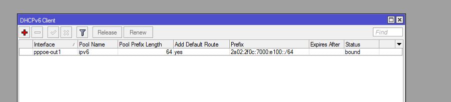

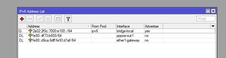

Hi all,
I am quite new using Mktik, I now have a RB951G-2HnD and my iSP gives PPPoE with IPv6 capability.
I have gone trough some settings in IPV6 on Winbox but testing IPV6 gives negative result, I am still connecting with IPV4.
Here are some screenshots of my IPV6 configuration as seen in Winbox.
Any suggestion/help is highly appreciated,
Thanks,
Dan
The screen shots look okay. What do your ipv6 routes look like?
Thanks for the reply!
Last evening I’ve re-configured IPV6 from zero and after a reboot it works!
