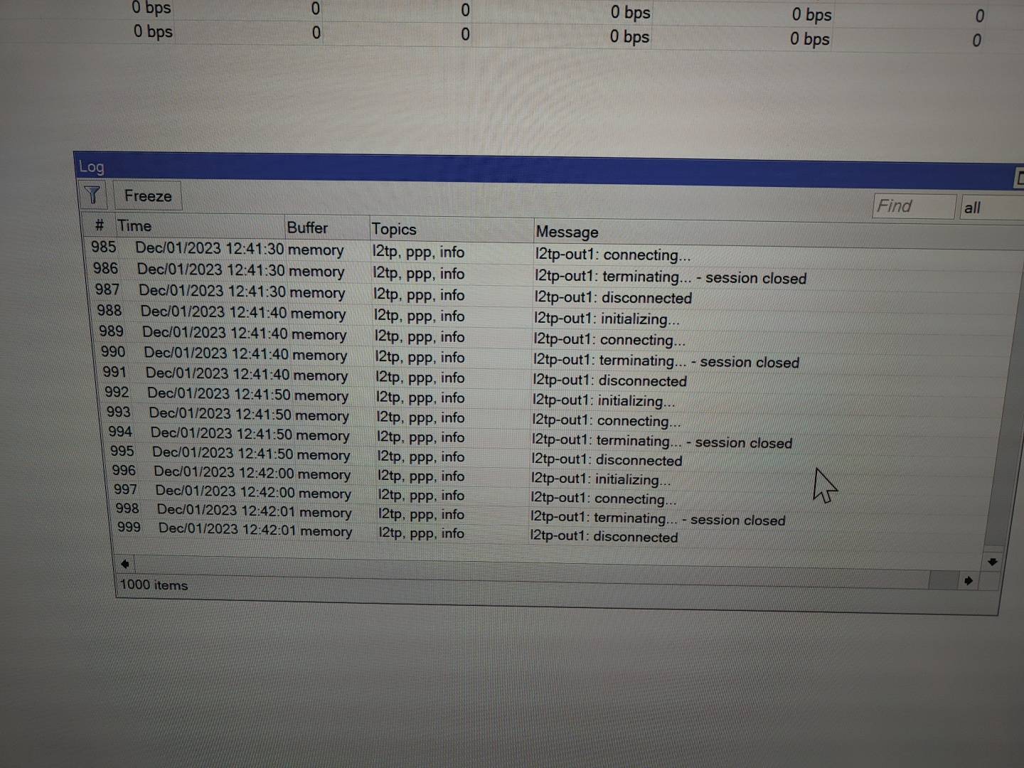

Well, I guess that didn’t add anything to my log as no extra info is being displayed there. It just shows as the attached picture.

I’m so sorry, I mistyped the command but now I have the log showing everything, I’ll attach a screenshot as I can’t make up anything of it.
You have leaked the public address of the server; if it bothers you, remove the screenshot.
Then, disable the L2TP client, wait 60 seconds, run /log print follow-only file=l2tp-start, enable the L2TP client, wait 60 seconds and stop the /log print… by pressing Ctrl-C. Then download the file l2tp-start.txt, use find&replace to substitute the IP of the server by l2tp.ser.ver.ip if you don’t want it to show it to the world, and paste the text here between [code] and [/code] tags. I need to see the L2TP startup from the very beginning.
