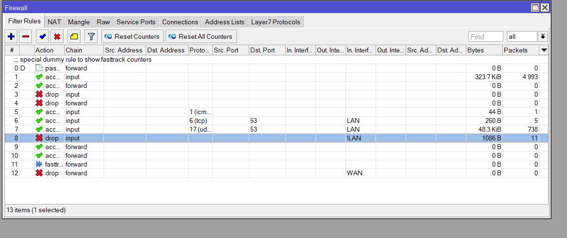

Am unable to ping any website or reach any website.
I have attached the firewall traffinc data as an image to this request. It shows no failures about DNS. When I try ping www.google.com on a standard windows powershell, the system complains of DNS failure.
The traffic on NAT interface shows 0 B.
Any guidance is welcome.

  2. Yes, indeed .. what you say makes sense. Have made the changes. That has pushed all heavy traffic rules upwards, and I think that would speed up the whole processing.
    Also, connection_state = new is only for the two DNS traffic rules - my conjecture was that this is a DNS issue. Can change those if needed.

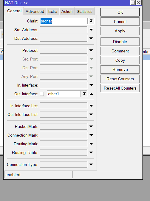

Am concerned about the NAT table (pic attached). The traffic says 0 Bytes - this possibly cannot be true (in my limited knowledge) - since the machines are trying to ping or reach some website.
The manual seems to say that a translation address should be specified - not sure how do I specify a DHCP allocated IP address to the NAT table. Any guidance on this would be deeply appreciated.

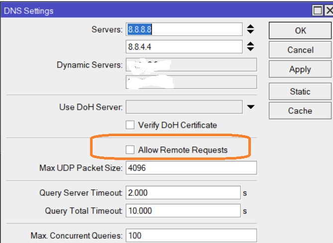

I have added the DNS (both the DHCP server entry (for local machines) and the DNS for the router (have used the Google public DNS addresses).

Okay, you need to check the box allowing remote requests, here!!!
Thanks So Much … it worked !!!
Could you point me to some write up that explains why this needs to be kept on and then use firewall filters to block off external DNS requests? At your convenience of course…
THis rule blocks all traffic to the Router (including external DNS), but allows LAN traffic, so you are okay.
add action=drop chain=input in-interface-list=!LAN log=yes log-prefix=!LAN
