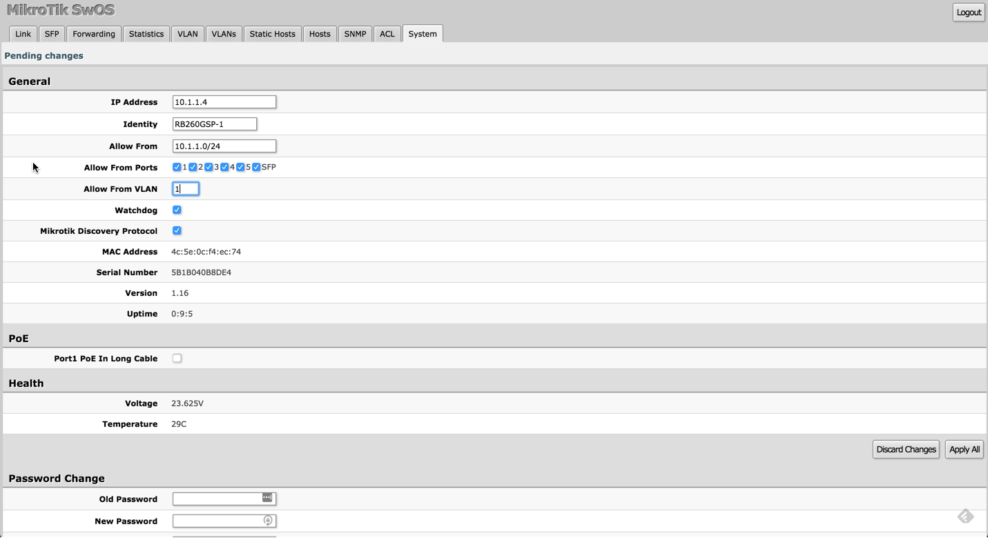

Basically I a couple of 260GSPs that I cannot get configured for the life of me… every time I think it is correct I just wind up loosing access to the switches and having to rest them. My goal is that I have three VLANs on my network 1, 100, and 1003. All are coming in to the 260GSPs via Port1 as tagged traffic. There is no untagged traffic and untagged traffic should be dropped. All of the three networks should be tagged on each of the other 5 ports (port 2 to port 5 and SFP). The admin interface should only be accessible via VLAN1.
Here is the settings I have… am I missing something or should this be working?
(Ignore the “pending changes”… I had to reset the switches again so I could get back on to take screenshots).

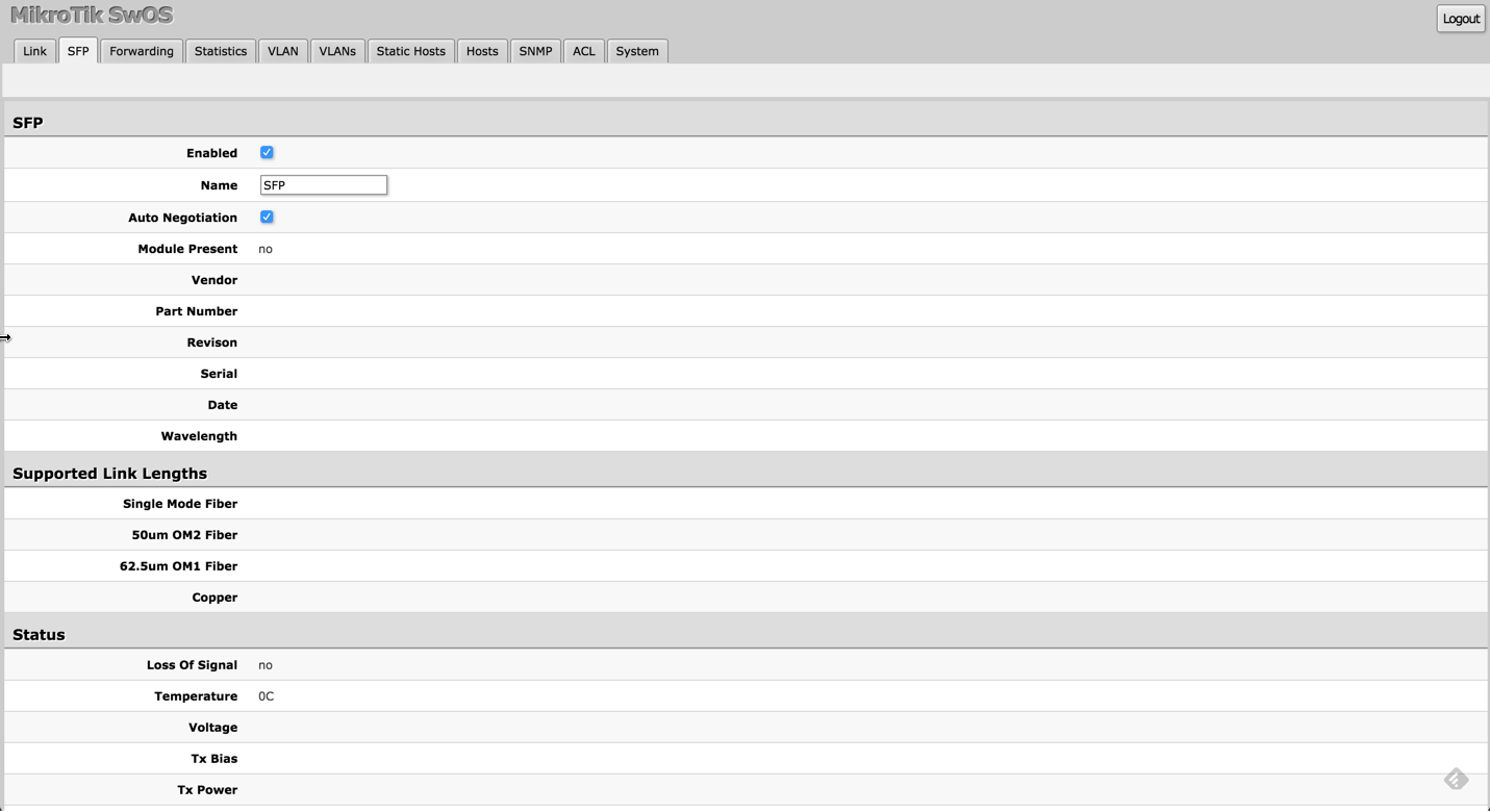

Some more images
Last image.
