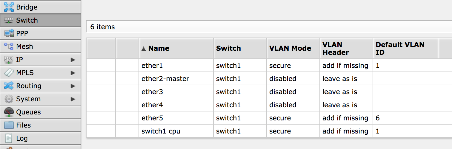

So here is what I have achieved now with switch chip that partly works

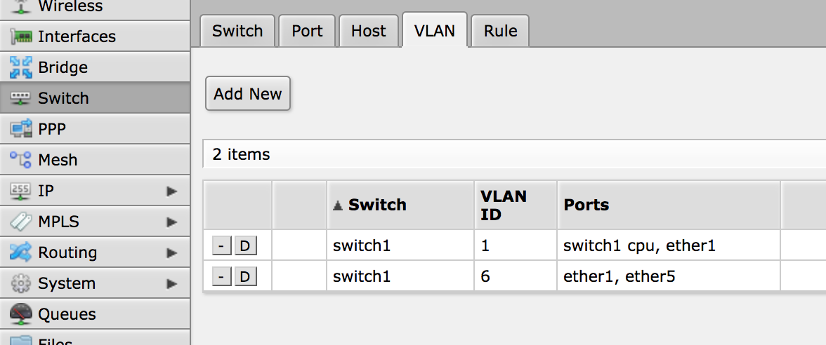

I’ve added 2 vlan’s
And configured ports for VLAN
So now I get IPTV on ether5 which is good, and also WIFI is getting internet connection.
The only problem is that I don’t know what to do with rest of ports ether2-master, ether3, ether4
When I connect cable to those ports DHCP doesn’t give any address
ether2-master belongs to “bridge” that was set by default in mikrotik config, wlan1(wifi) also belongs to same “bridge”
DHCP serves IP’s to “bridge”
Any idea what I’m missing here, how to enable those ports?
