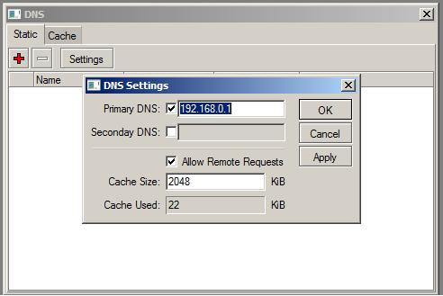

thanks for the infos I looked into that and this is what I got. I tried taking the 192.168.0.1 out and put 10.5.50.1 but after a reset it defaults back to 192.168.0.1 (I guess what it picked up from dhcp on ether1)
So I think that is also setup right. Strange …

primary DNS must be the address of a valid DNS server that can answer to DNS requests, use what your ISP gave you
hmmm I seem to have done this. in dhcp client. I uncheck use peer dns (ether1 would pick up linksys router dns 192.168.0.1 “Public net” )and under DNS I added my 2 dns servers from my isp. Then back on the Mikrotik local network, I did a release and renew and I got a local ip fine 10.5.50.252 with gateawy 10.5.50.1 and my isp dns.. So that seems to be working. Now back to routing I still can ping the gateway ip 10.5.50.1 (Mikrotik) but nothing else. I cant even ping the dns that I have received from DHCP. Now from winbox I can access telnet and log into the Mikrotik os from there I can ping google or any other web address or ip(shows that ether1 is working fine) and I can also ping the dns servers fine.
