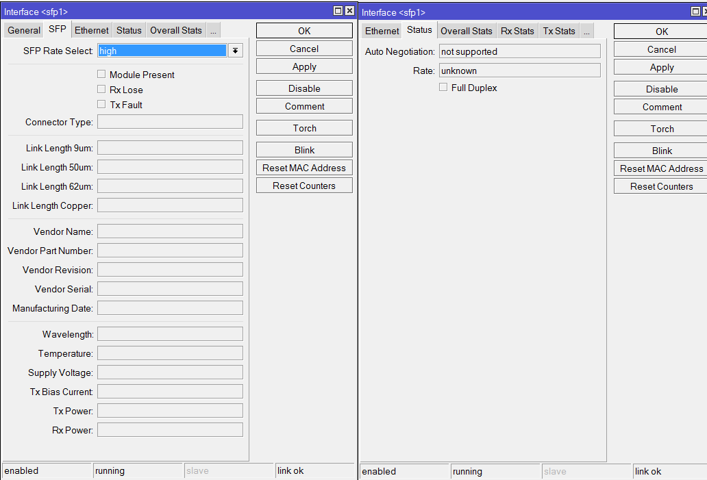

Have 2xRB2011 with TP-Link TL-SM321A/B v6.0rc9
Link is fine and running but on SFP status TAB there is no Info
Same on my 2011, link is ok but no further status information, I guess 2011 hardware does not support it.

I’ve upgraded the RoS to 5.23 and am unable to even see the ‘SFP’ tab inside the ‘sfp1’ interface.

RB2011 board does not support diagnostics for SFP

Therefore should I be seeing the ‘SFP’ tab as per the first post or not? - I am unsing a 2011LS-IN
I understand that the 2011 series does not have diagnostic support but should not the tab still be visible?

at first I was confused about that but it seams “SFP” Tab is available only in 6.x

RB2011 actually does say that “SFP DDMI” is not supported: http://routerboard.com/RB2011UAS-2HnD-IN
