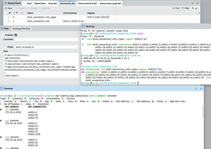

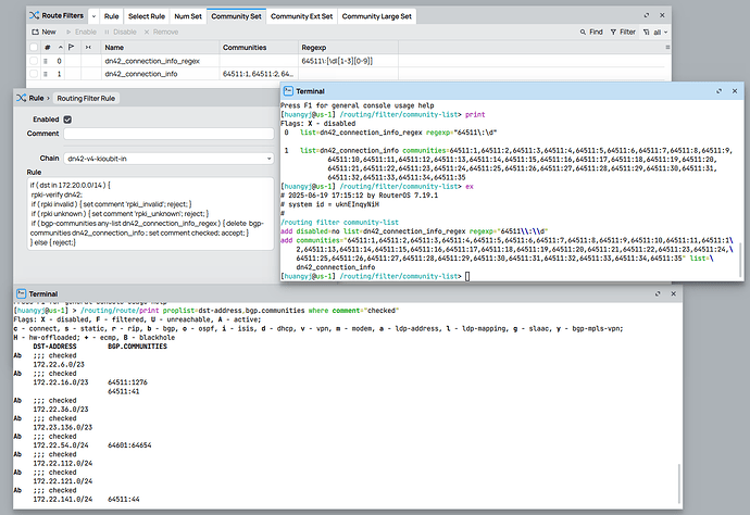

  1. Adding regexp items behaves strangely:
  • I can add new items via the console with type=regexp, but the content of “regexp” displays differently in Winbox versus the console (what the heck?).
  • After adding a regexp item via the console, I can modify the “regexp” content in Winbox without triggering the “invalid regexp” error.
  1. Inconsistent behavior when applying the list in filtering rules:
  • The list works for matching routes but fails to delete communities.
  • Here are the two community lists I configured:
`/routing filter community-list
add list=dn42_connection_info_regex regexp=“64511\:\d”
add list=dn42_connection_info communities=“64511:1,64511:2,64511:3,64511:4,64511:5,64511:6,64511:7,64511:8,64511:9,64511:10,64511:11,64511:12,64511:13,64511:14,64511:15,64511:16,64511:17,64511:18,64511:19,64511:20,64511:21,64511:22,64511:23,64511:24,64511:25,64511:26,64511:27,64511:28,64511:29,64511:30,64511:31,64511:32,64511:33,64511:34,64511:35”`

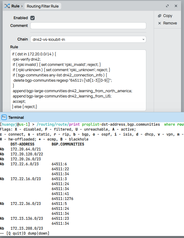

  1. Testing filtering rules:
    (Note: In Winbox, the regexp is set to "64511\:[\d|[1-3][0-9]]".)
  • if (bgp-communities any-list dn42_connection_info_regex) { delete bgp-communities dn42_connection_info_regex; accept; }
    → Matches correctly, but deletion fails.
  • if (bgp-communities any-list dn42_connection_info) { delete bgp-communities dn42_connection_info_regex; accept; }
  • if (bgp-communities any-list dn42_connection_info_regex) { delete bgp-communities dn42_connection_info; accept; }
    → Matches correctly, deletion succeeds.
  • if (bgp-communities any-list dn42_connection_info) { delete bgp-communities dn42_connection_info; accept; }

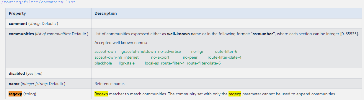

  3. As stated in the documentation. community list entry with just a regexp parameter is used only for matching.
  1. Typing in CLI should be add list=dn42_connection_info_regex regexp=“64511\\:\\d”, the codes I’ve pasted are copied from export. But the real problem is that content in CLI/export is different from content shown in winbox.

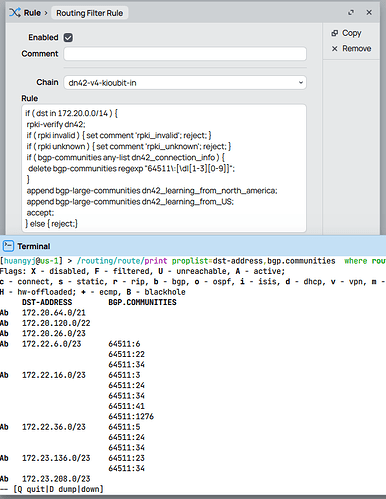

  2. I’ve also tried using regex directly in filter rule like delete bgp-communities regexp "64511\:[\d|[1-3][0-9]]"; , but still not working.

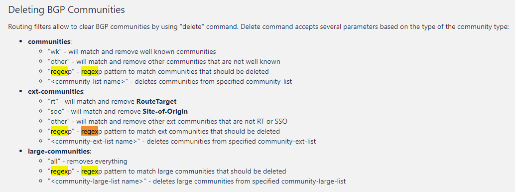

I’ve read the document, but it just noticed that regex can not using to append. So I think it means that deletion or filtering should works. If only matching is supported, how about changing the description?
