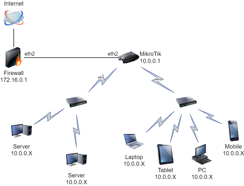

Greetings,
I am trying to achieve the following (hope my diagram is clear enough):
At the moment, communication with 10.0.0.X and 172.16.0.X is working, along with internet access but I doubt I am using best practices or optimal configuration as I am using only IP addresses list, a bridge and routes. Also, one issue that I have, it that I cannot seem to configure port forwarding correctly as all the connection to a port, for example 3389 to a server in the 10.0.0X range goes immediately to an external client address (not my public IP address).
I am aware that I need to make modifications to my configuration, I was told to use VLANs to route traffic correctly, after reading on the subject, I noticed that it was preferable to use bridge VLANs.
This is where I am struggling, I have no real idea where to start and this is my first time using VLANs and this is where I need help.
The way I understand it, 172.16.0.X should be isolated, as well as 10.0.0.X to be able to identify traffic properly (correct me if I am wrong).
May anyone help me in setting this up please?
If you have any question, please let me know, I will do my best to answer them.

Can you forward ports on the firewall ???
Assuming yes, then you need to do that for all the port forwardings you wish to accomplish.
The MT can also accept NON-standard ports and convert them to the port your require at the server.
Then you have to apply port forwarding on the MT.

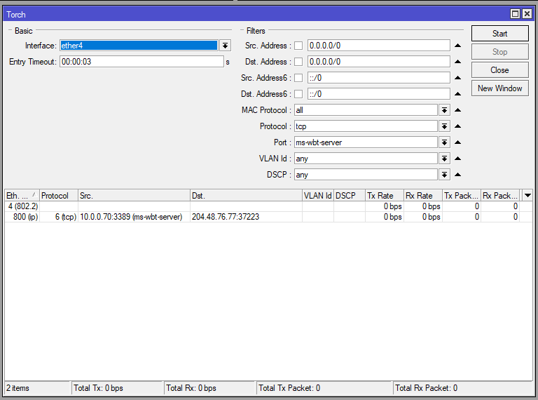

  • In the MikroTik, I see the following when I try to access port 3389 (example with an external network):
I will keep reading and doing some tests later today, I will post an update on my progress, but please consider I am not an expert, I might still need help figuring this out.

Greetings,
As requested, I made a “cleaned-up” working and “far from optimal or according to best practices since I am learning” config as requested.

You can’t dstnat through a routing layer like that. For a rule like this:

I was not aware that you could add three addresses to the bridge?
How do devices know which subnet they belong too??
Not the usual config I am used to seeing, why the strange approach?
This is a mix of lack of knowledge and partial information from other network admins I spoke with. As I said above, I think VLAN is the way to resolve the subnet issue. THis was also, originally, configured like that as a temporary measure to eventually learn and get some help with VLANs.
Even worse why is the WAN address part of the bridge.???

Good. Let the nit-picking begin.
We can begin with the fact that your new config is so clean it doesn’t have any dstnat rules at all. How were you planning to allow inbound connections?
add address=172.16.0.2/12 interface=ether1 network=172.16.0.0
You’ve assigned the entire RFC1918 “172” space to your DMZ. (The subnet between your “Firewall” box and the private 10-dot LAN.) The intent is that you use /16 at biggest, and in your case, /24 more than suffices unless you’ve left out over 251 DMZ hosts from your diagram. /16 is 64k IPs, and /12 is over a million.
Likewise, assigning the entire 10/8 subnet to the private LAN is an overreach, particularly given your stated plan to subnet it with VLANs later. (A topic we’ll revisit next.) Using a /24 is quite common here as well.
use VLANs to “isolate” the subnets
That isn’t going to solve the security concerns you buy with all of this.
Think about it: you put the DB server on one VLAN, the DNS server on another, the mail server on another…and then you add routing and NAT rules to allow everyone outside into each VLAN separately? What have you bought?
The point of VLANs is indeed to isolate one VLAN from the other, but then you go purposefully punching holes between them!
The best you could accomplish with that move is reduce the risk of, say, a hole in the DNS server from allowing island-hopping into your mail server. But, since the mail server will need DNS, and it’s cheaper to contact a local cache than the public DNS servers, you’ll likely end up with your mail server’s VLAN routed to the DNS server’s VLAN, risking a total removal of the isolation advantage.
None of this is easy. It’s why infosec is a field unto itself. You can spend an entire career learning and practicing its precepts.

As for port forwarding, I plugged in the cable going from to the MikroTik in the WAN port as it was also discussed earlier, I assigned a static IP in the range of the firewall to the MikroTik WAN port ether1.
I tried to do a port forward as you recommended:
add action=dst-nat chain=dstnat comment=RDP dst-address=172.16.0.2 \
dst-port=3389 protocol=tcp src-port="" to-addresses=10.0.0.70 to-ports=3389
No success so far though, I think I am still missing something but I did read online and watched a few tutorials, they mostly all suggest a rule similar to yours, but they are never “hit” and the counter always stays at 0 when I try to connect from a completely external network. Am I missing something here?
If I use use the Torch tool, I never see anything going to the tcp protocol on port 3389.
Thank you for all the information again!
Do you mean you have this WatchGuard box out of the way entirely now?
Another option is to swap their roles, making the hEX the border router and putting the WatchGuard box between it and the private LAN. That would let you put it in bridge mode, avoiding a double-NAT layer.
This may solve your dstnat problem, because your current rules depend on the inbound packets to be directed to 172.16.0.2, but you don’t say how the WatchGuard box or the “Internet” box (presumably a modem of some kind) does that. If you put the modem into bridge mode and set the hEX up as a border router, then you wouldn’t need the dst-address rule at all. You’d say something more like:

I might have not been clear enough with me explication earlier, the cable from the WatchGuard now goes from its ether2 port to the port ether1 of the MikroTik. Earlier, it was still plugged in the port ether2 of the WatchGuard, but also plugged in the port ether2 of the MikroTik, disregarding completely the ether1 port of the MikroTik. As stated by anav the ether2 port on the MikroTik was part of the bridge, so the WAN port as well, now that it is plugged in ether1, the WAN port is no longer in the bridge as well.
Then I repeat: swap their roles and put the WatchGuard box and the Internet modem into bridge mode. That will let the hEX “see” the Internet directly, where it can best do dstnat type stuff. It will also give it the best possible vantage for providing VPN service.

I understand what you mean by that, let me provide more information about what is “beyond” the MikroTik:
  • I have static IPs from my ISP, the only way to have that with them and also access to ports like 80, 443 and the like, they needed to put a modem and router, both of which I do not have access to.
  • My public IP is not supposed to change.
  • The WAN port of the WatchGuard is plugged in the ether2 port of the ISP’s.
  • I also do understand that my setup is not ideal, I would gladly remove the WatchGuard but it was a gift, I really wanted to explore it and try to use it as a firewall before the MikroTik, I do understand that this creates a problem and is unconventional. I was able to make the port forwarding work at some point, but if I recall correctly, internet was slow because I had a routing triangle at the time and I was told to look at the VLAN alternative for a configuration such as what I was doing. I will start to look at the options you suggested.
Your ISP requires unencrypted HTTP management access to the modem/router from the WAN side? Run away, run away!
Security aside, this means you can never port-forward 80 and 443 inside the LAN, because the modem/router is going to catch it, every time.
If you can convince yourself you don’t need HTTP/S inside (e.g. you’re dropping HTTP and moving your public HTTPS service(s) out into the cloud somewhere) then you still need to configure the ISP modem to do port-forwarding separately, since it’s acting as a NAT layer.
I asked whether you removed it, but I advised that you swap its role with the MikroTIk router, putting it between the router and the private LAN, in bridge mode, so that it behaves transparently until it needs to step in and filter something.
But, that advice was based on the idea that this would put the public IP on the hEX’s WAN port, vastly simplifying dstnat, which sounds like it is not the case.
