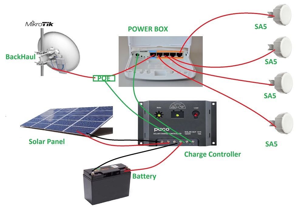

i am new to scripts need some help. we have some remote WISP sites installed, powering through solar system,power-box is used to power-up the devices. we want to minimize the power usage to improve backup of system. so we simply decided to power off the sector from 12:AM to 7:AM
to reduce night power usage.
so we want to design a script and schedule, which check clock time in power box (clock is synced with ntp server) and power off and power on poe ports on desired schedule.
