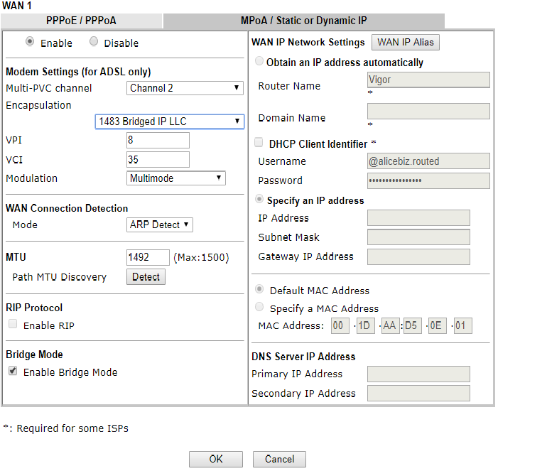

Now the modem in bridge mode it’s in the same subnet of the Mikrotik,
so i have only re-set the mode in PPoe mode, enable dhcp server on it, disable PPPoE interface on mikrotik, and after??
A modem in bridge mode in the same subnet as Mikrotik sounds really strange. Can you paste here output of “/interface export hide-sensitive”, “/ip address export” and “ip arp print” after replacing any eventual public address there with some p1.p1.p1.p1 value?

“24 DC 192.168.98.98 00:1D:AA:D5:0E:00 bridge” This is the ip of the Main Router (Draytek) In bridge mode
The attachment file it’s the configuration-mode of the Drayteck
Okay. So you already do have a PPPoE client interface there as expected. What I cannot really understand is how comes that although the modem is connected to ether1, which is not a member port of your bridge named “bridge”, it is accessible using an IP address from the same subnet like the rest of your devices, but let’s leave this aside.
As it seems the basic of this configuration (before you’ve set up the L2TP/IPsec) has been created using the “Quick set” function of WebFig or Winbox, you are not aware at all of some settings that need to be made.
