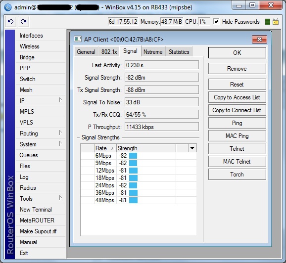

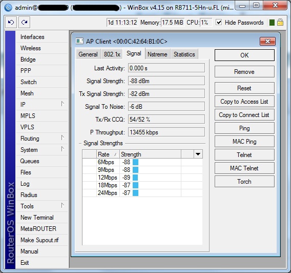

Looking closer at this connection I can see that on the AP side the noise margin is listed 35ish, but on the client side it says negative noise margin, which is impossible, because then I couldnt connect to it!
The client screenshot is taken by winboxing over the client connection.
What is the reason for these figures?? :open_mouth: Can you agree with me that the noise margin listed simply cannot be correct?

-Why the two ends report 33 and -6 dB noise margin, respectively. They should be equal, although opposite, right? Theoretical throughput is listed as 12Mbps-ish
-Why a link is maintained although client reports negative noise margin.

Signal to noise is just that, the difference between your noise floor and your signal level. Each end of the link is going to have different noise levels depending on surrounding noise. So on the end that has the -82 signal with 33 Signal to noise your noise floor is -115 and on the other end with the -88 signal with the -6 Signal to Noise the noise floor is -82. Even if your noise level is higher than your signal you can still get and maintain a connection but you will have disconnections and a lot of retransmissions.
