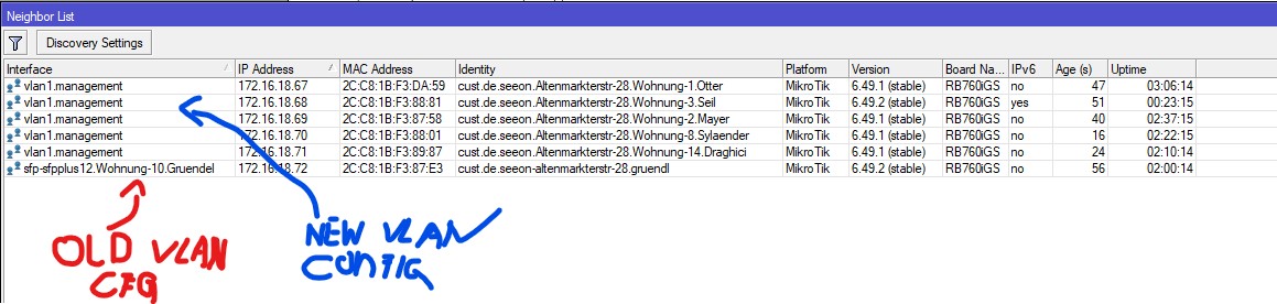

having an issue with “Neighbor Discovery” when doing VLAN with ROS as it should be.
I can not see the CDPs from the Mikrotik-CPE when doing VLAN-Filtering (Bridge VLAN configuration - the NEW way to do this) instead of adding VLAN-Interface to SFP-Interface and bridge it together with ether1 (the old way to do this).
Only when setting frame-types=all and adding VLAN ID 1 (CPE-Port-PVID) and add a VLAN-Interface ID 1 tagged on BRIDGE1 (Switch) i can see the devices in Neighbor Discovery but only on “vlan1”-Interface (vlan1 is assigned as VLAN-Interface of bridge1).
