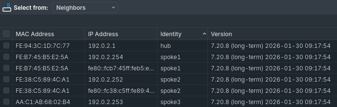

I’m seeing an odd behaviour with neighbour discovery on bridge interfaces. When I open up WinBox and look at the neighbours, I see both IPv4 and IPv6 entries for interfaces that aren’t bridges, but only IPv4 entries for bridge interfaces. I can’t see any significant differences between the entries when I check from the RouterOS CLI. Any thoughts from the community before I open a ticket?

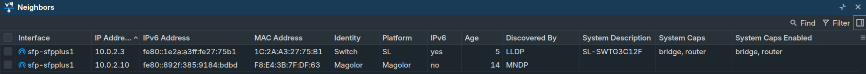

This is what I have connect
SODOLA SL-SWTG3C12F switch
MNDP discovery runniing on ubuntu
I get how MNDP works. Everything is working except for the missing IPv6 entries. To illustrate, here's what I'm getting in my WinBox on a client connected to the spoke3 router's bridge:
I'm figuring I should be seeing IPv6 entries for the hub and for spoke3 (both of which are bridge interfaces) just like I do for spoke1 and spoke2 (which are not bridge interfaces) but this isn't the case.

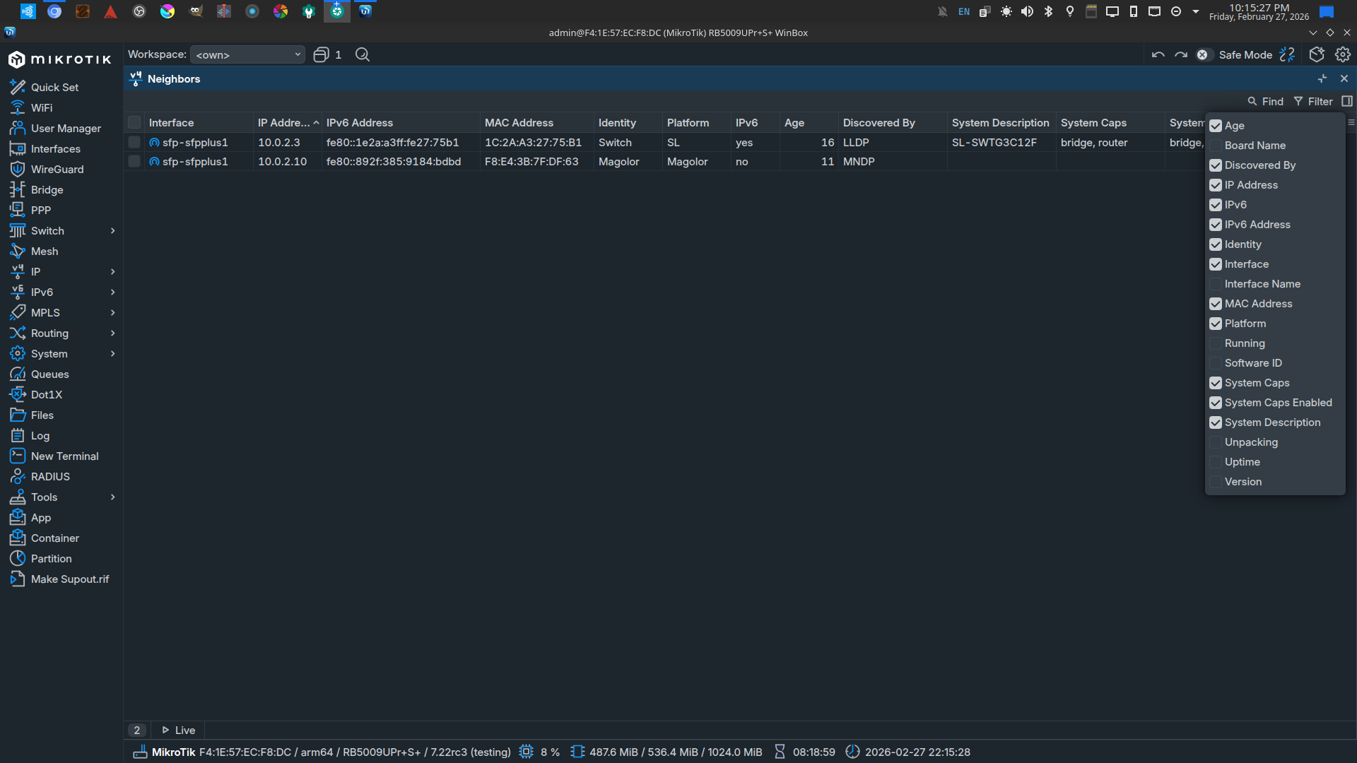

I see what your saying. Click on the pancake icon (the 3 lines) column selection and check box ipv6 address
I’m not running ipv6 so there are link-local.
Also, could be a version difference since I’m on 7.22rc3
You’re looking at the router’s IP Neighbours panel after logging in. I’m looking at WinBox’s Neighbours before logging in. These have different options and entries.
