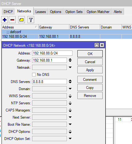

DHCP was enabled by default. I have set up the DHCP reservations and some NAT rules just like they are in my current router (not mikrotik).
First it was a pain getting the 5Ghz network running (turns out it is a MUST to set the country for it to work)
After switching the routers and connecting wan cable into mikrotik it received the IP address and DNS servers from the ISP.
Trying to load any page resulted in timeout as no hostname could be resolved (unless it was cached in OS)
Checking the ipconfig /all showed that DNS server is the mikrotik router.

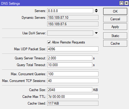

I changed the DNS server in the router to 8.8.8.8 but nothing changed. I could verify that after reconnecting the wifi, the new dns server was used.

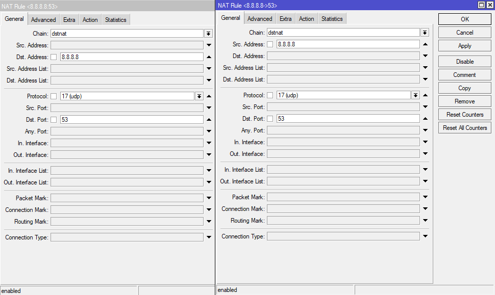

I thought that mikrotik was blocking the requests so i added two NAT rules. One to allow traffic on UDP 53 to 8.8.8.8 and another to allow trafic on UDP 53 from 8.8.8.8
It is still not working and hostnames cannot be resolved.

Sorry people. I have found out i did a very silly mistake. I had NAT rules without dst address specified. They were for portt 80 and 443. So all the trafic was being redirected addres which was not available at the time.
All started working after i corrected the NAT rules.
