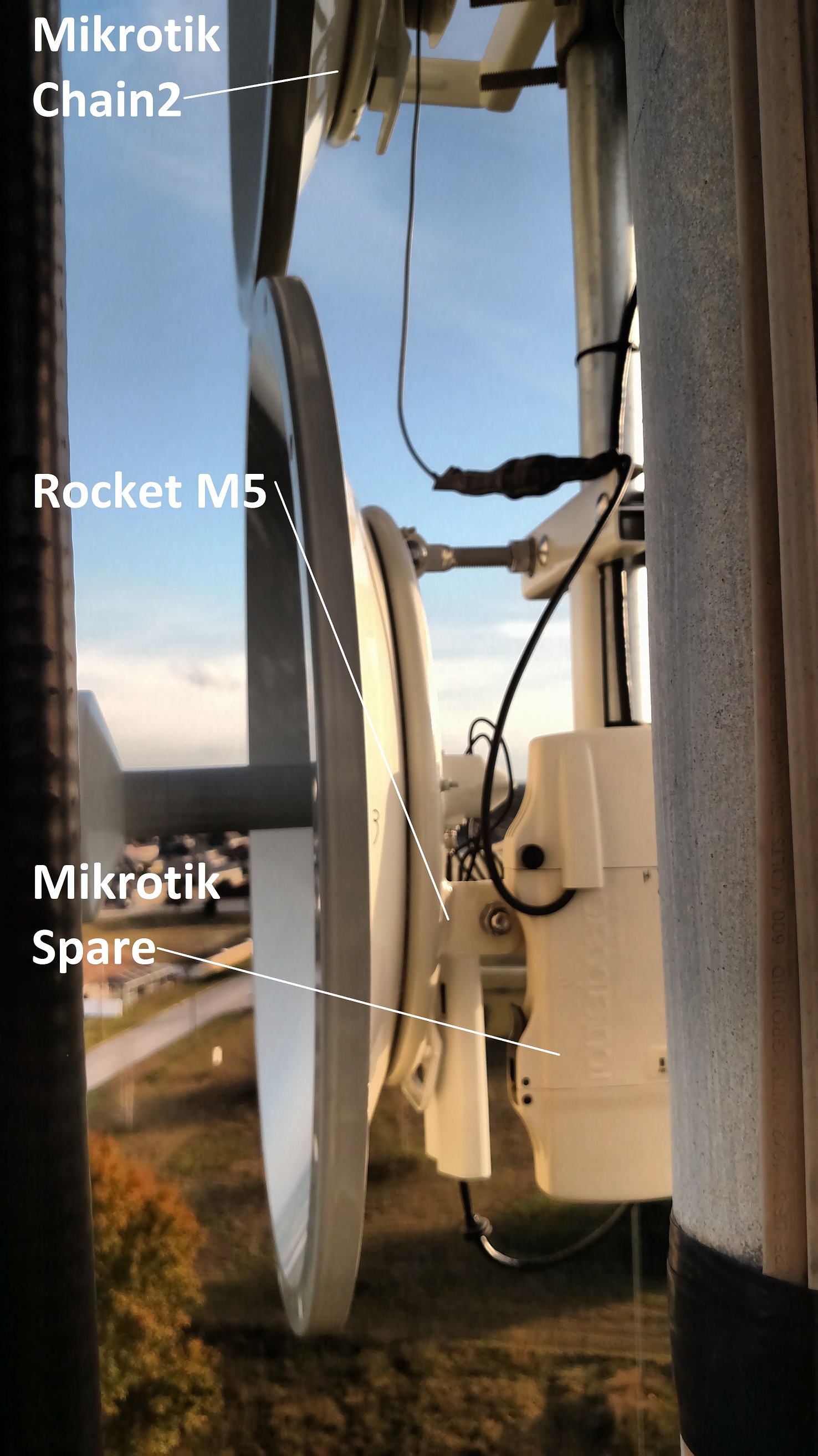

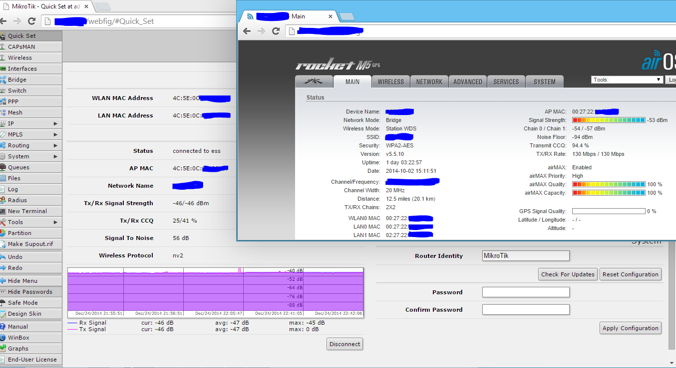

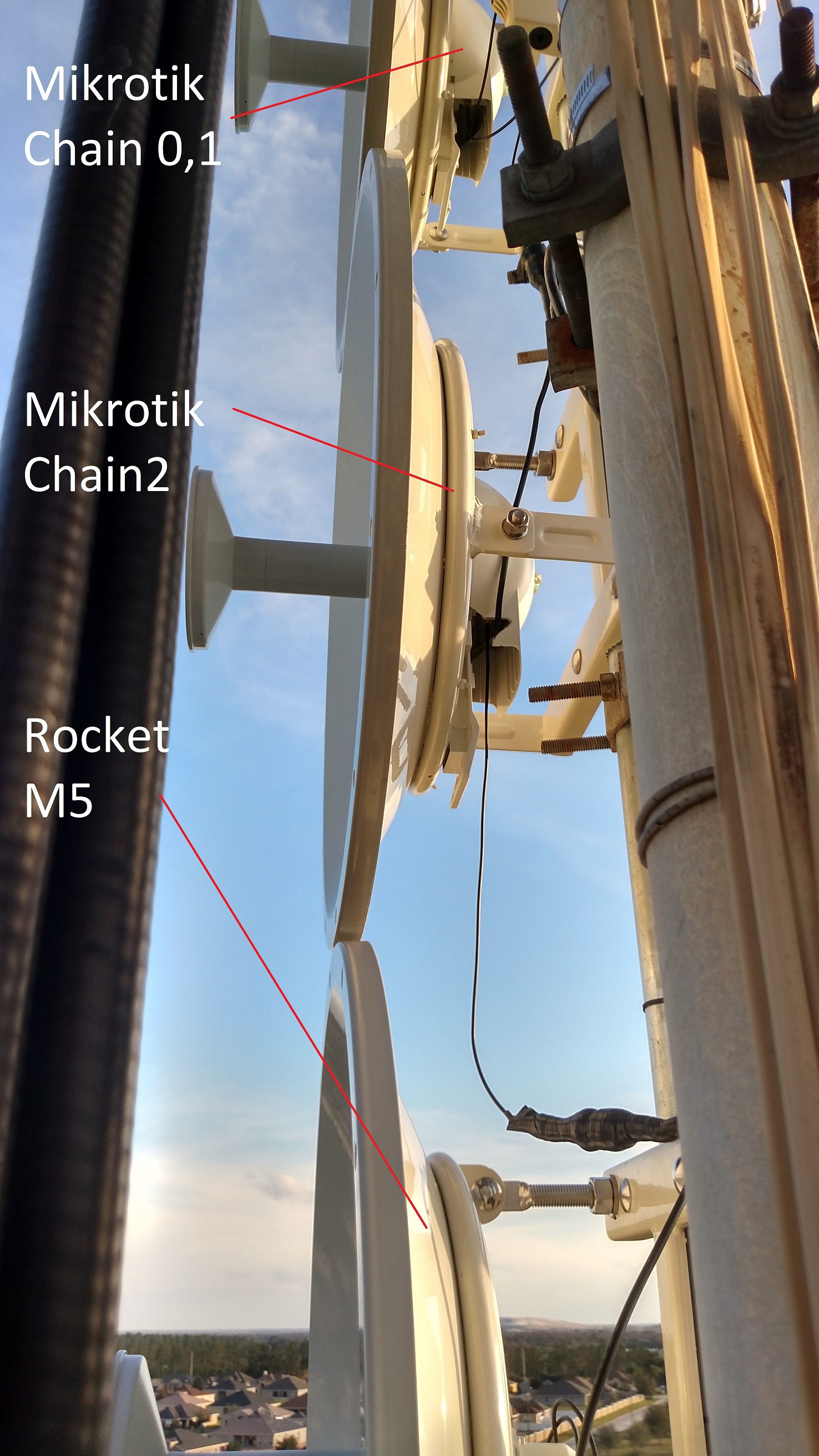

I am doing a side-by-side comparison of Mikrotik NM5 AC and Rocket M5. The Mikrotik has about 4-6db better signal than the UBNT. These are connected to 2 RD30s on each end of a 22km link, mounted 5ft apart. The 3rd RD30 is for Chain2 but from what I read I need more physical distance between it and Chain 0/1 to get the 3x3 benefits.
I’m not seeing the speed I should be getting but at least the signal is what it should be.(RocketM5 is 80mb/s with rates locked at 130/130. Mikrotik is 40mb/s. Wish I could lock the Mikrotik rates) I’m trying to find the magic combination but being new to Mikrotik, the learning curve is quite steep. It doesn’t help that half of the wireless features are not supported in 802.11ac but there is nothing to tell you this, you just get to guess whether the change you made did anything or not.
