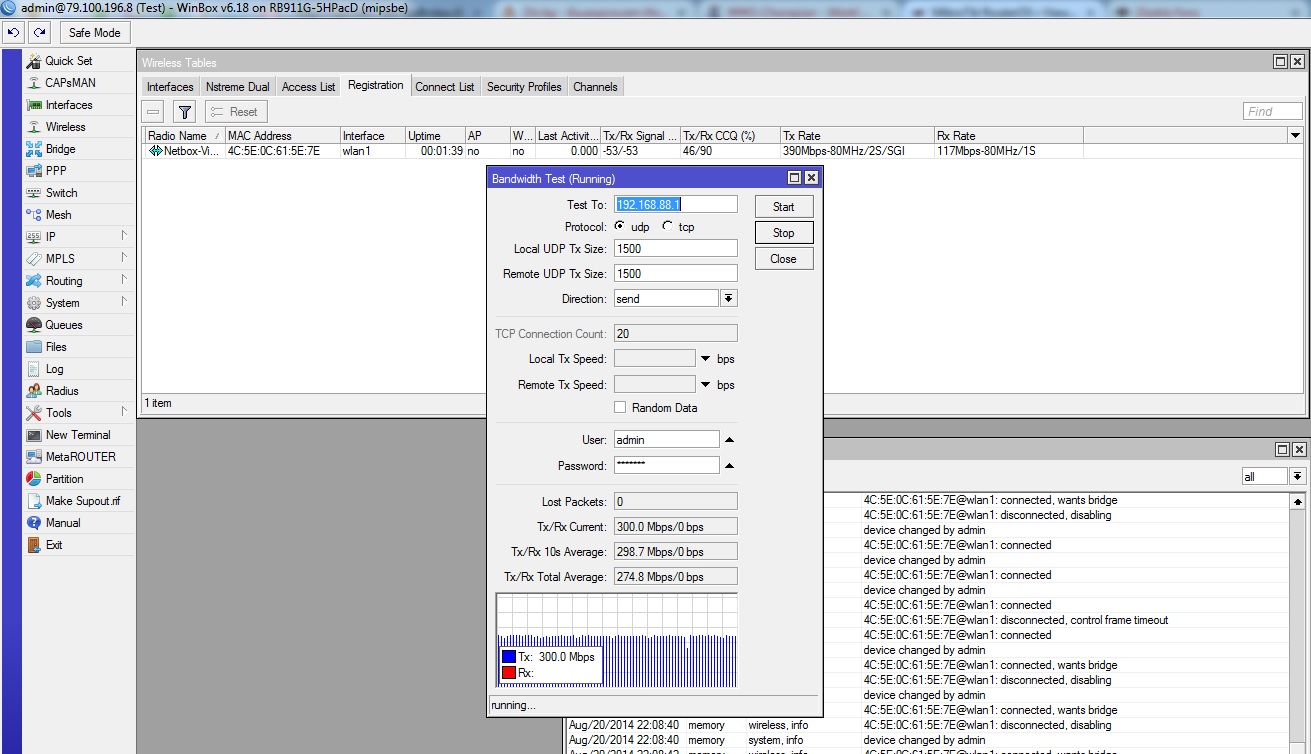

First test conditions :

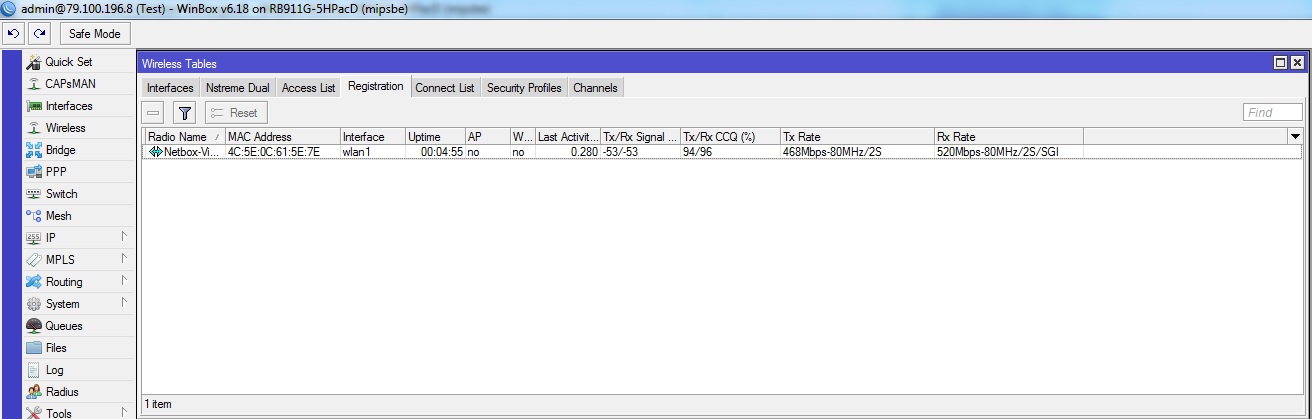

Devices are in two different rooms separated by a wall with omni 1,5db antennas attached to them.
band : 5Ghz-only-ac
channel width : 20/40/80Mhz Ceee
protocol : 802.11
Test is done between the boards - not the perfect I know, but devices are currently in an office with 100mbit/s lan attached.

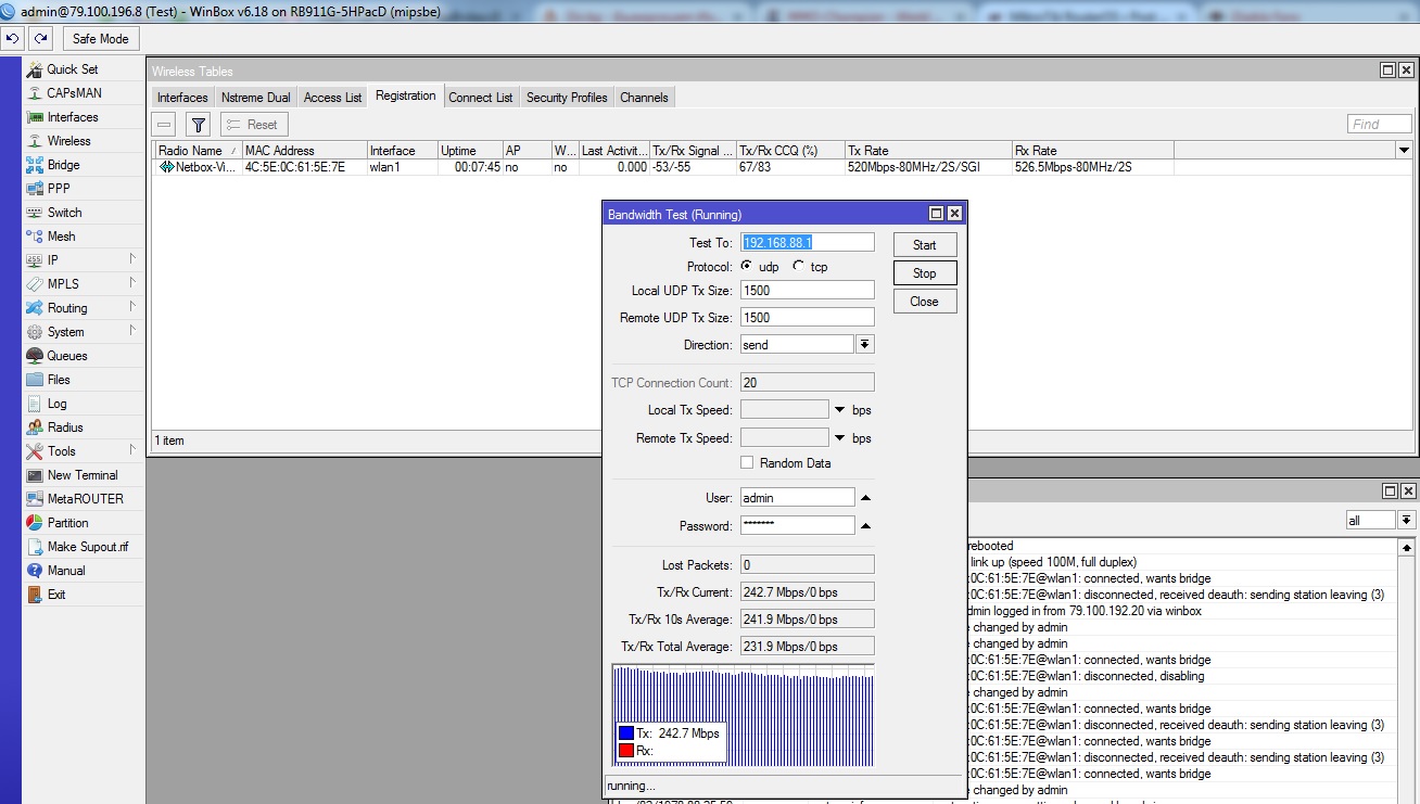

2nd test everything is the same except :
protocol : nstreme
I expected better throughput here, but it is worse than plain 802.11ac. Maybe I need to play with frequencies a bit.

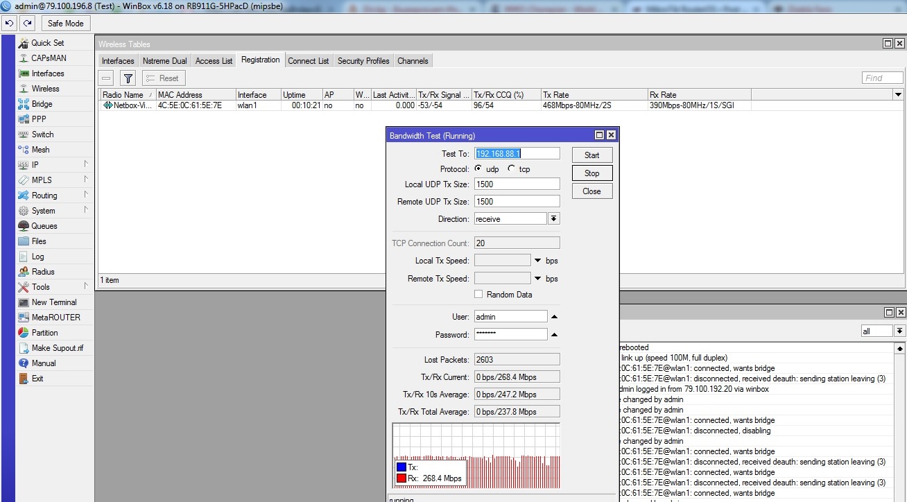

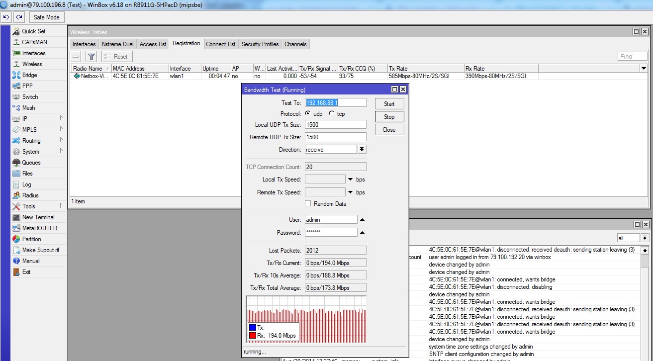

Better result, again 802.11, everything the same different frequency :
Tested nv2 aswell, but the results are bad - the throughput is very unstable. I will not be doing anymore tests inside - with these antennas I cannot go more than 520Mbit/s wireless rate even though the signal is very good.

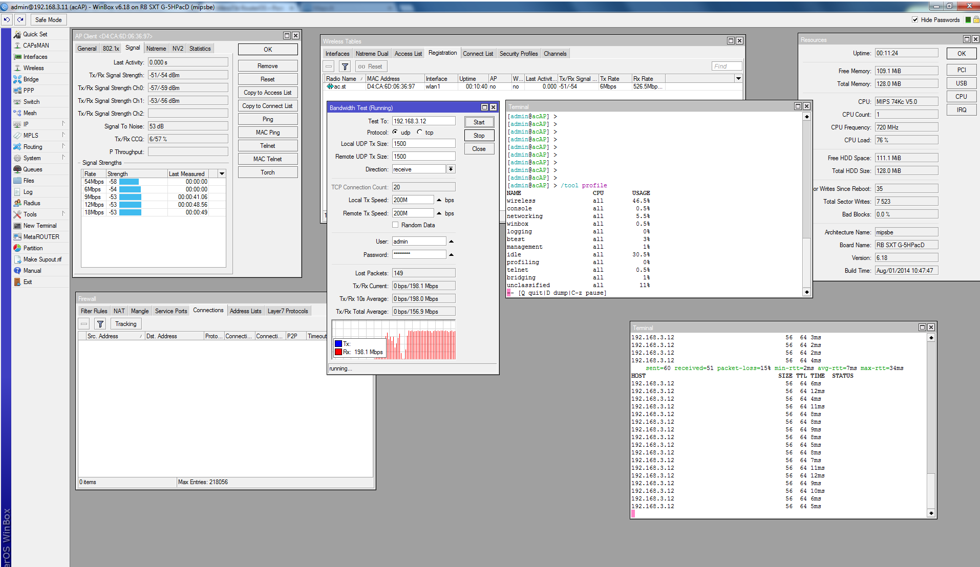

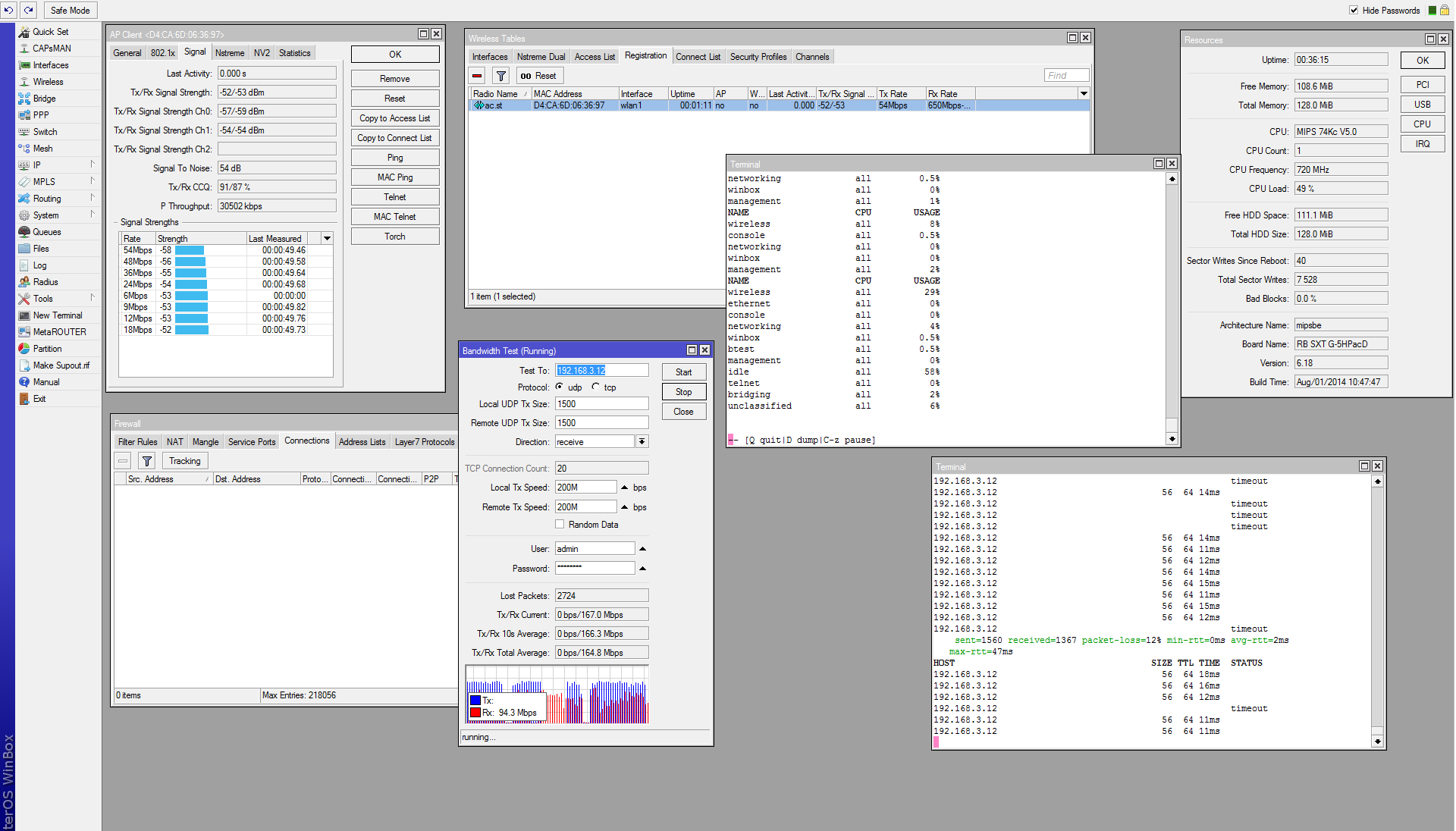

Bellow are my tests, done with 2 RB SXT G-5HPacD v6.18 with wireless-fp in ptp mode (configured via quickset as wds bridge)
Devices are installed on towers (1 - 50 m height, other - 45m, perfect LOS, distance -between them 0,85 km)
Tests was done from AP side, because it is connected via fiber.
Tests was done with btest. I have tested with limited speed to 200 Mbit send/receive/both.

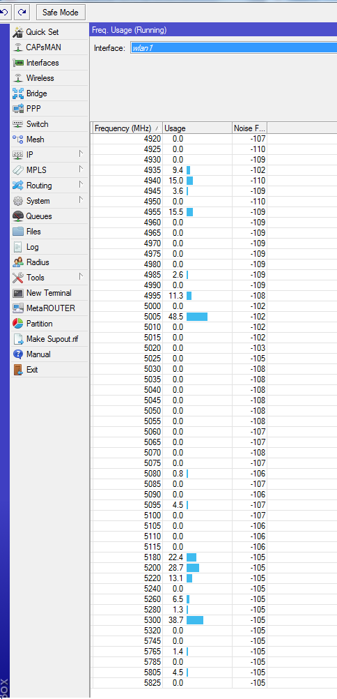

This is freq usage picture from ap side: (strange is that AP is crashing on frequency scaning mode…probably bug?)
So i did tests on several frequencies, to be sure, that there is no influence from other links and superchannel mode.
  1. The frequency 5045 Mhz (superchannel) was selected due to noisy environment.
Continue reading…
Tests for NV2 protocol
1a - protocol nv2
transfer to station
receiption from station
Duplex rate to station

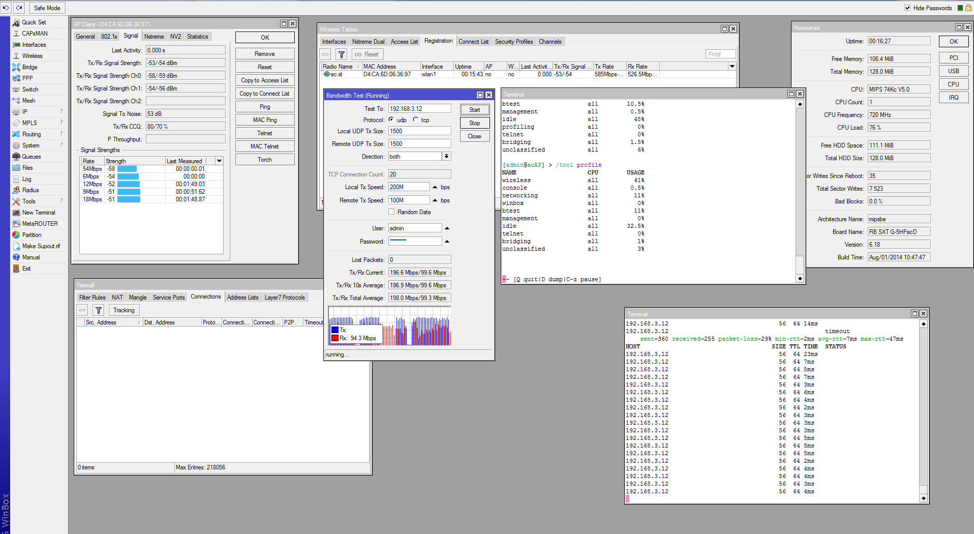

I have noticed, that there is no possibility to get 200Mbits full duplex from this link,
so i have reduced rx rate to 100Mbit.
IMO there is problem with radio link, not cpu limitation.
And what the hell? to what to believe when measuring cpu load ? tool profile, or to winbox resources window???

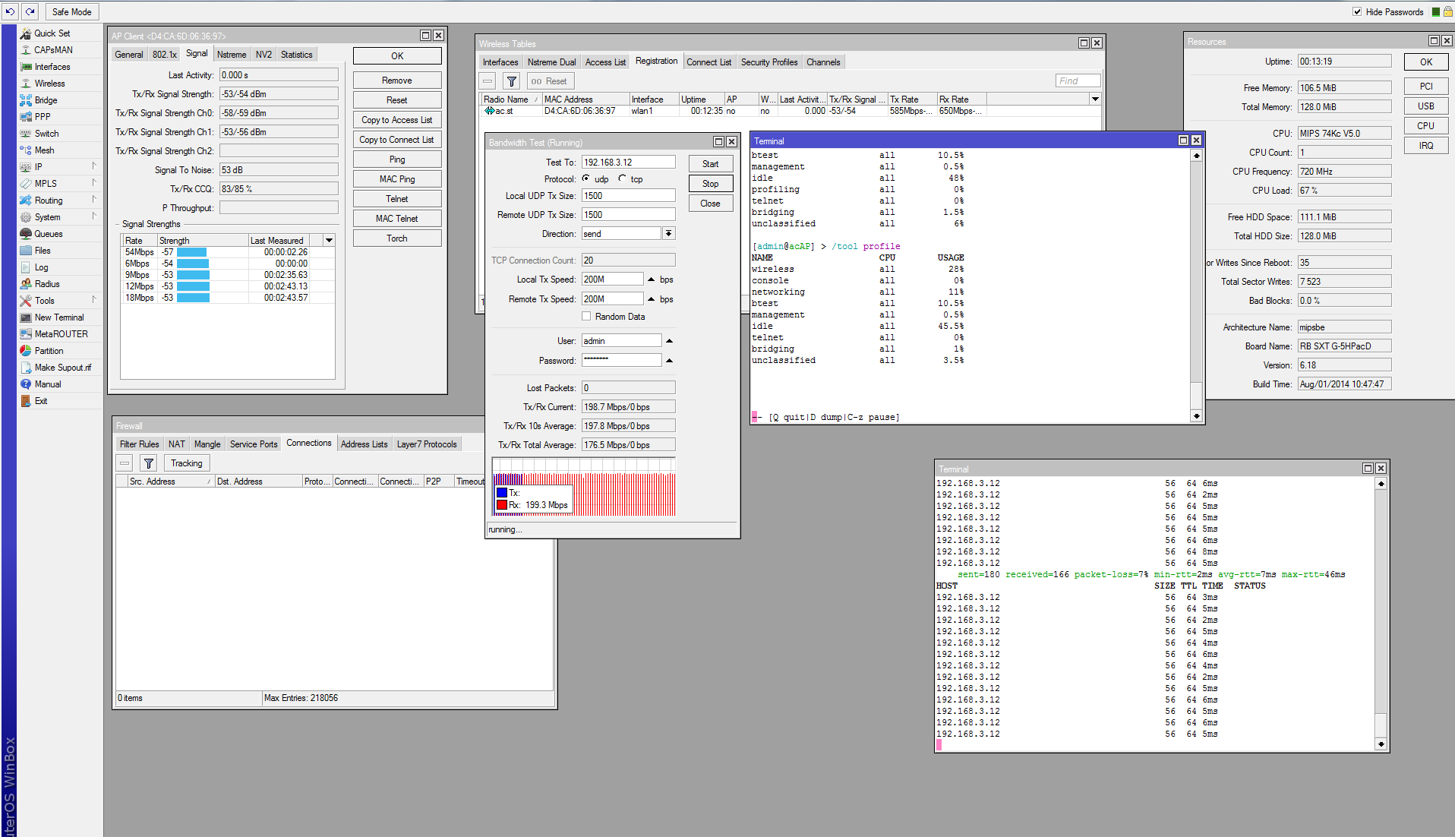

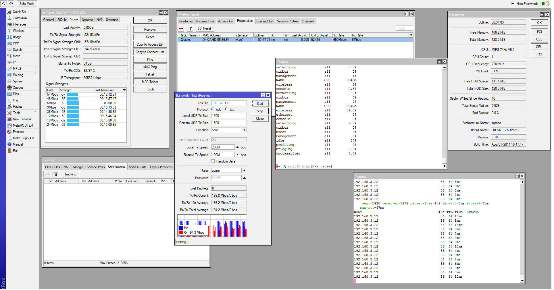

Next tests with Nstreme (enabled polling, framer policy - best fit, framer limit - 4000)
TX
RX

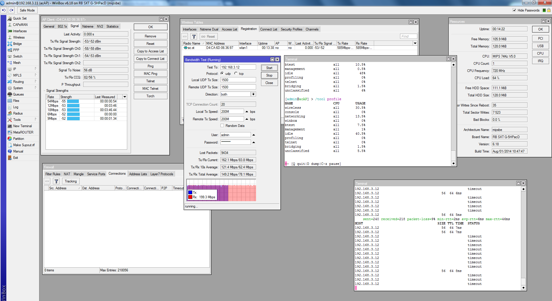

Note! this test was succsessful only from 3rd hit, first ones was ended with station disconnection
Next ----- duplex on nstreme

Duplex 200/200 Mbits
after crashes works, but poor and without response to pings from station
Here is Duplex 200/100 Mbits
Quick note:
Only possible way to get results is before aplying “both” test, is to start one way tests (first receive and after send or vice versa)
