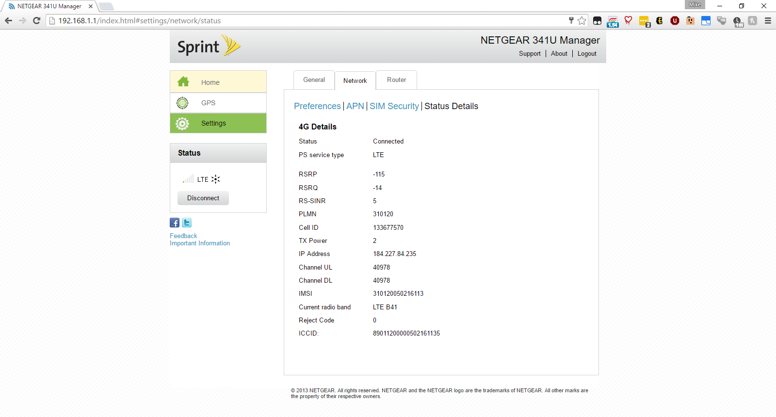

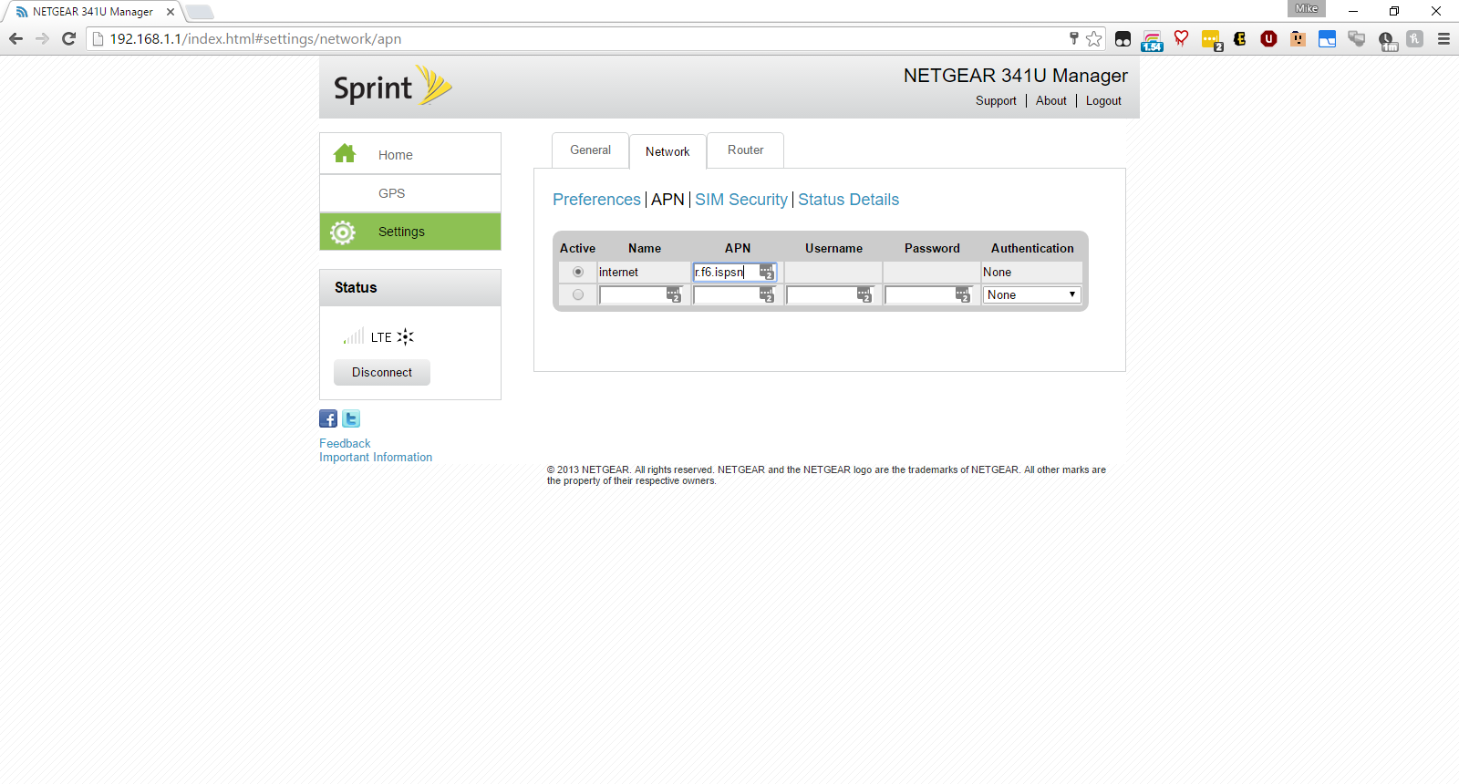

Can you compare my settings with yours? Trying to figure out what’s different.

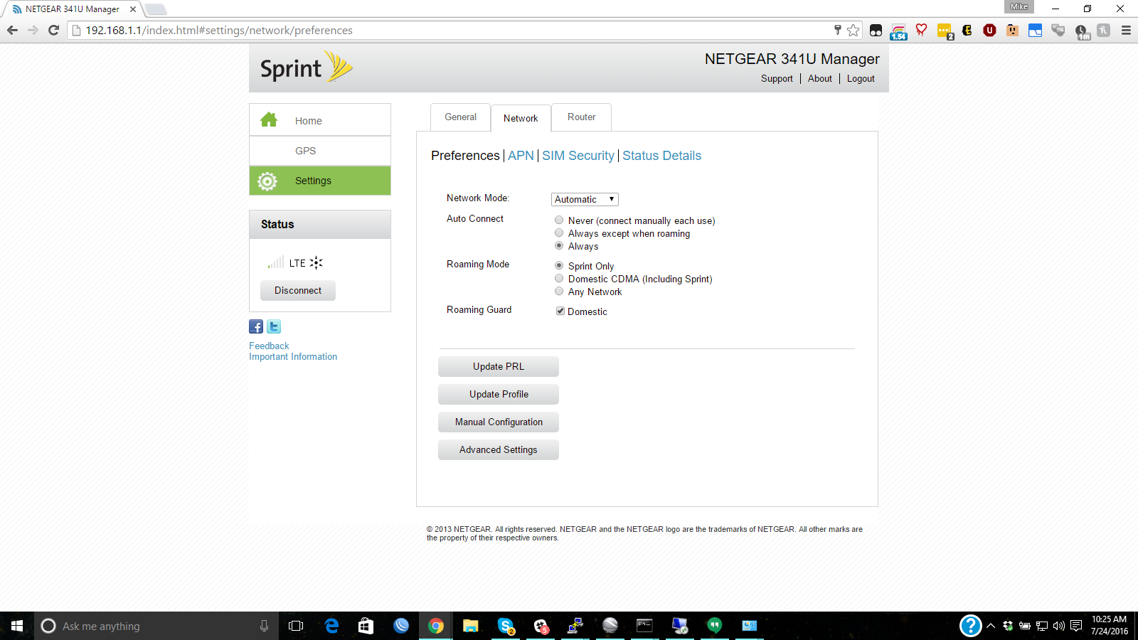

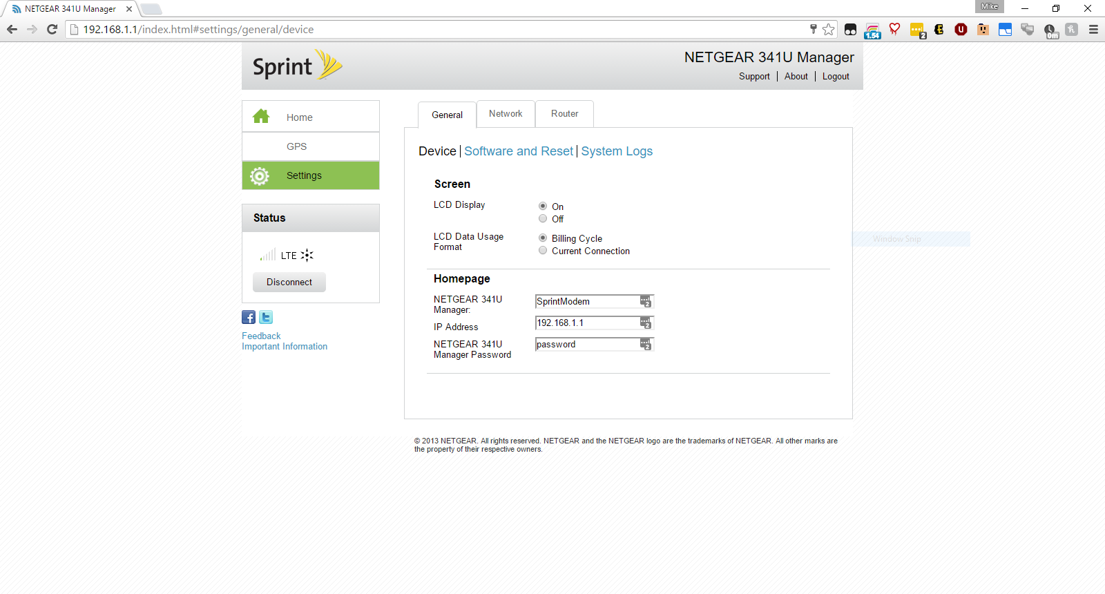

More screen shots.
The only thing you must do is to enable “Ip pass through” mode. I couldn’t use this modem in default NAT mode. See screenshot number 3.
Don’t forget to use right APN name in modem init string. In my example, it is different from your APN name.
