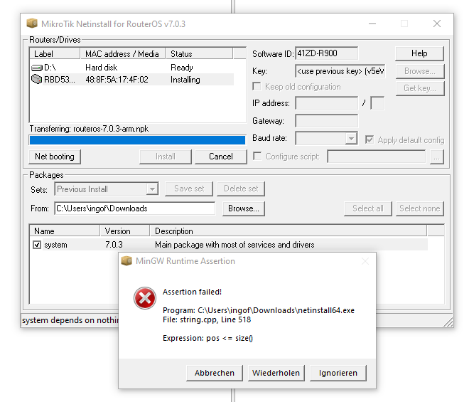

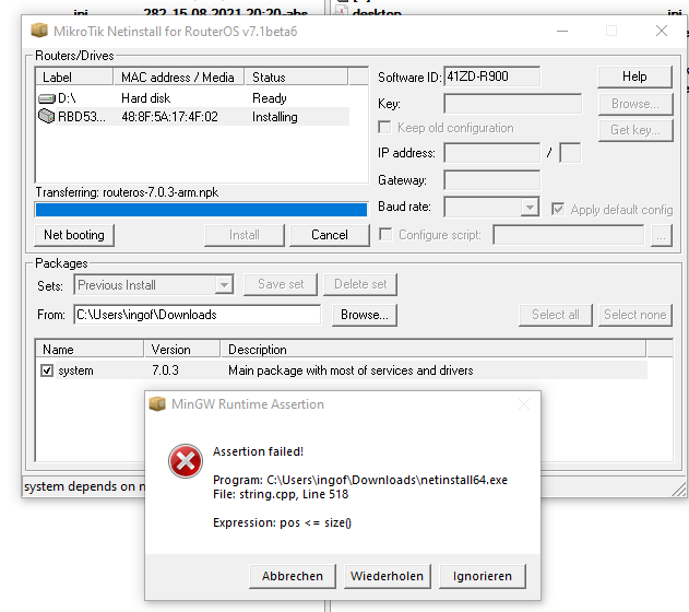

Regardless of netinstall version. It happens with netinstall 7.1rc1, 7.0.3, 6.48.4. It just does not matter which version. Always the “assertation failed” error.
Mikrotik support could not help me, as it “must be a local issue” of mine.
Windows 10 21H1 / 19043.1165

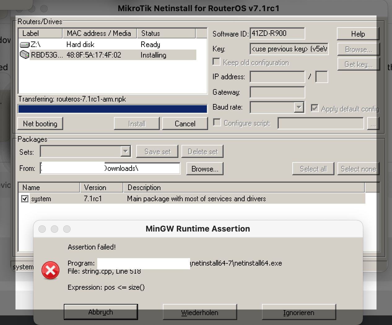

Let’s try on my Manjaro Linux machine. I failed to get this netinstall.exe running on Wine. At least the device showed up - but I could not start the installation itself.
So now on my Macbook Pro, Big Sur, installed wine-stable and it runs.
But you know what? The same f*** error when I execute the netinstall on this f*** device of Chateau LTE12.
What happened to this particular Mikrotik device? This error does not go away. No matter how often I re-try netinstall.

I had the same issue. Sent to support. Note that the netinstall completes successfully. You just have to manually reboot the device.
Win10 netinstall/netinstall64 7.1rc1 RB2011.
I tried to netinstall from 2 completely different computers.
ONE Windows 10 PC
ONE APPLE MacOS
Both show the same error message.
This is clearly not a "oh my damn personal computer is messed up" thing.

Regarding Chateau and its secret stable: look at my screenshots in opening post. I tried to flash ROS 7.0.3 with 7.0.3 netinstall. 7.0.3 is the current official stable ROS release for Chateau. If one cannot flash this version that runs on thousands of other Chateaus - what the heck.
Basically one observation I made:
Despite the error-message, the Chateau directly reboots afterwards automatically and boots up successfully.
Even though the device works afterwards it is still frightening to run a device with confidence, when Netinstall showed such a fatal error.
