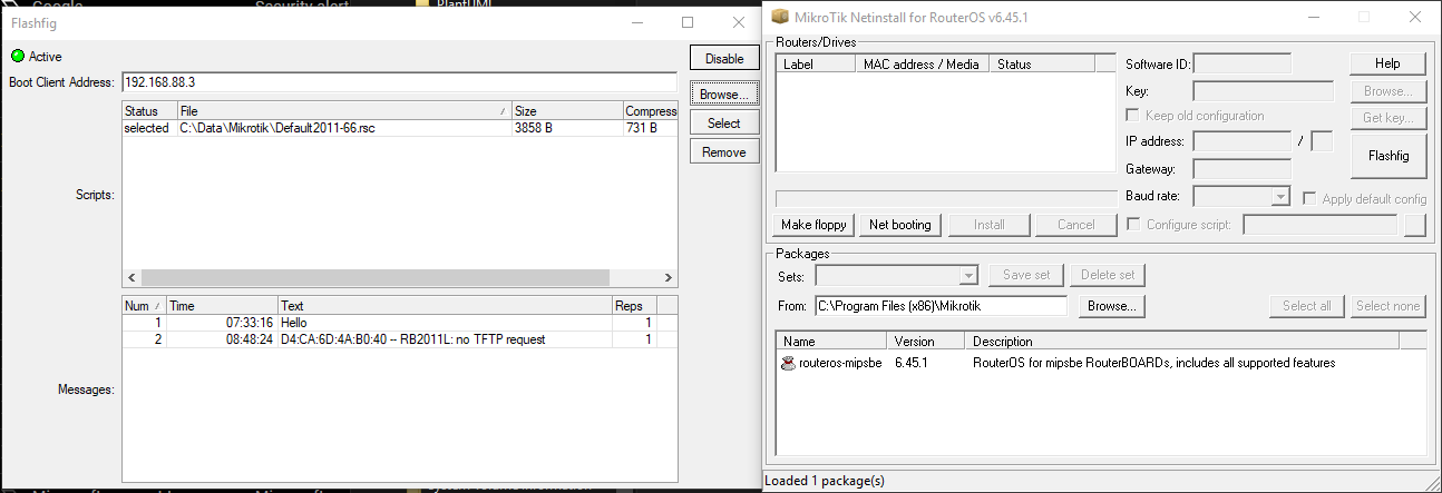

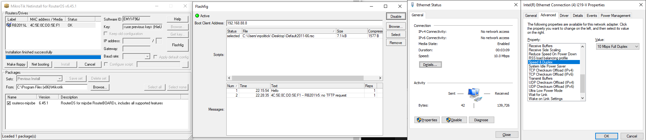

Is the Flashing utility still functional with V6.45.1 ?
I’m trying to flash an RB2011 and the Flashing tool keeps on giving an error: “no TFTP Request”.
Please see attached PNG.
Is the this documentation correct ? https://wiki.mikrotik.com/wiki/Manual:Flashfig
Where it says it applies to V4 and not V4+ … But the doco says that all RB come with flashing enabled since 2010 …
I’ve even tried starting it as Administrator, because it seems to listen on UDP:69 TFTP and other lower than 1024 port numbers.
My laptop IP address is 192.68.88.8,
as indicated on the PNG, the RB2011 is 192.168.88.3. The ARP table on the laptop supports this:
ARP -a :
Interface: 192.168.66.8 --- 0x14
  Internet Address      Physical Address      Type
  192.168.66.255        ff-ff-ff-ff-ff-ff     static
  192.168.88.3          d4-ca-6d-4a-b0-40     dynamic
  224.0.0.22            01-00-5e-00-00-16     static
  224.0.0.251           01-00-5e-00-00-fb     static
  224.0.0.252           01-00-5e-00-00-fc     static
  239.255.255.250       01-00-5e-7f-ff-fa     static
  255.255.255.255       ff-ff-ff-ff-ff-ff     static

Review your PCs IP address. It shows 192.168.66.8
Hold the reset longer, 20secs or more.
I had a similar problem trying to netinstall recently - after putting bootloader in netinstall mode it came up with IP, and downloaded the small “flash-OS” image that’s embedded in the netinstall program, but after booting that flasher and resetting network ports it was not listening to “start download” command from netinstall.
For me it was solved by switching the laptop ethernet port to 100Mbps full duplex.
No fricking idea why it helped - it makes no sense as link was up at 1Gb and I could see the port 5000 (or was it 4000?) ready-to-netinstall announcement packets from the routerboard, but it did help.
So maybe try.
Thx wrkq, but that didn’t work for me
Tried that, at 10Mbps just to make sure packets were not coming “too fast” for the RB2011, but same result. This time I’m using a newer RB2011 hardware, but same problem with 6.45.1
