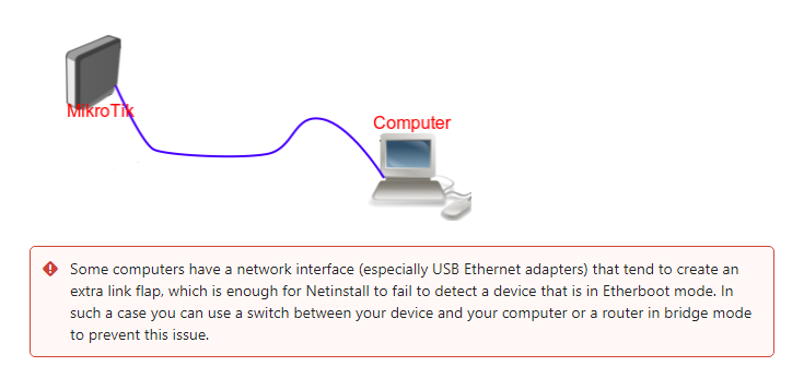

I thought I saw someone even recommending putting switch between the router being netinstalled and a windows computer. I wasn’t able to find what I thought I remembered, but possibly it was this in the ROS documentation:
https://help.mikrotik.com/docs/display/ROS/Netinstall
Thanks to your prompting, I did try a dumb switch, and it did work, but that led me to the question, “Why?”

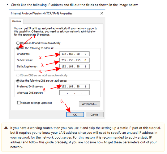

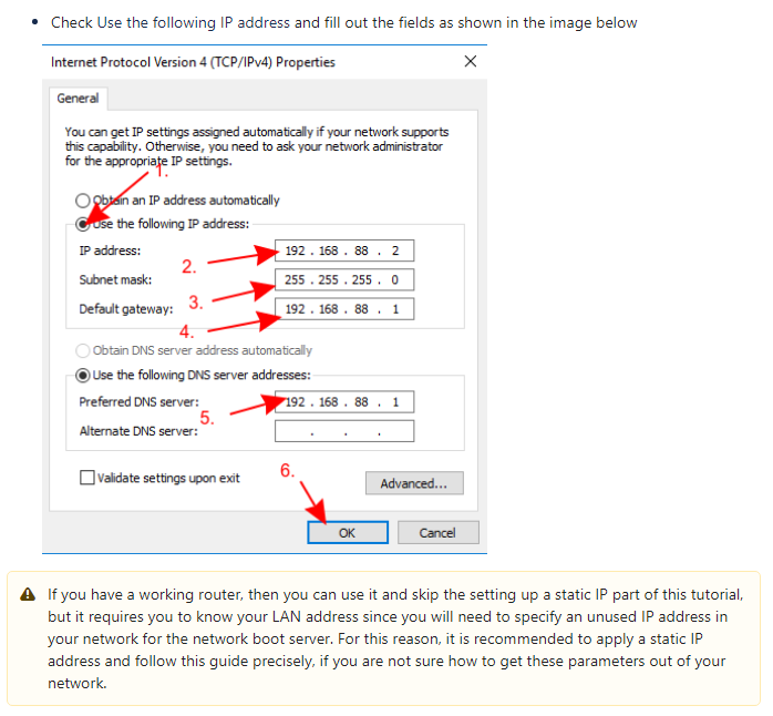

What is also bad is that the instructions for switching the ip address to static are incomplete; the ip address doesn’t get changed until you “OK” on the ethernet properties screen. I know, because I wasted time “troubleshooting” a problem when I assumed I had changed my adapter’s ip address, but it had not ever been changed. I always verify it is correct with ipconfig /all after making a change, but before continuing with whatever needed the ip address changed.
The documentation has two hints that you don’t have to use a static address. But they recommend it for people that are not familiar with netinstall.
Following are the two places in the netinstall docs that give the hints (and the second shows what I consider to be misleading at best, that #6 is what “changes the ip address”. It does not. Don’t take my word for it, try it yourself and use ipconfig to verify what the address is after #6 and then again after you press “OK” on the parent Ethernet properties window.
