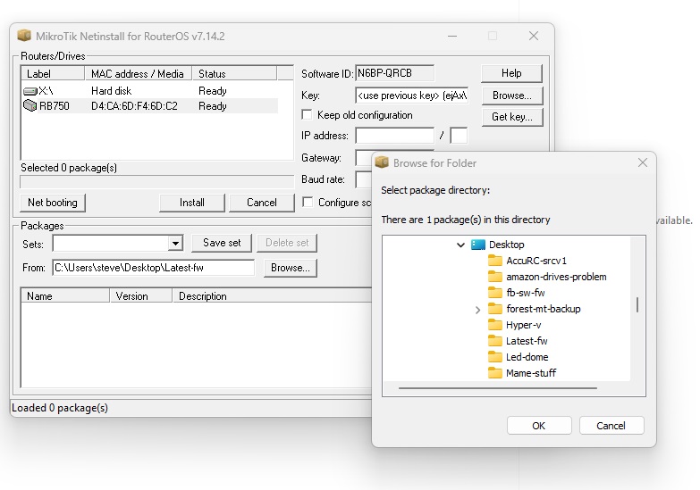

Please see my screenshots to go with this attempt to describe what’s going on:
I have followed the Instructions, networking is setup correctly and router shows up as expected.
However cannot select RouterOS package.
Says 1-package found in directory but cannot view or select it.
Can select folder but shows then blank “loaded 0 packages”.
There is certainly the routeros npk file in that folder I am trying to load.
If I restart netinstall It then shows the package selected but install button is grayed out and key is not shown or visible.
If I click on the displayed router it then shows the existing key but package selected disappears, is blank and shows “loaded 0 packages” again and unable to select install.
And attempts to browse to the package location does the same problem as above, and does not show up.
I have tried every combination of restarting netinstall and booting up the Mikrotik in netinstall mode while netinstall is running or not running.
Same result.
I am confused.
Just starting netinstall (with Mikrotik router already up & running in netinstall mode) router shows up and shows package “routeros 7.14.2 Main package with most of services and drivers”
As selected and about to be installed but router key field and install button are blank/not available (grayed out)"
If I click on the router that is shown they existing key appears and then the package selection at the bottom disappears (is gone) and browsing for it will not make it re-appear.
Shown in screenshots.
What am I doing wrong here?
Thanks!

In screenshot 2 … select router first and then package … or this still doesn’t do the trick?
Also make sure that the routeros npk file you have available is for the CPU architecture of your RB750 (it seems that RB750 is MIPSBE but verify yourself).
The RG750 is mipsbe device.
https://cdn.mikrotik.com/routeros/7.14.2/routeros-7.14.2-mipsbe.npk
Not arm
Thanks!
I’ll try that. Thought it was ARM.

And of course this worked. (as expected).
