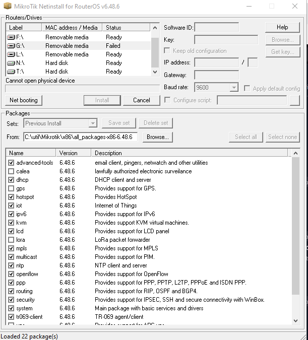

The problem today is as follows:
using 6.48.6 I downloaded everything from the website.
using the 32 or 64 bit netinstall it fails everytime with Cannot open physical drive.
I’ve tried 1gb, 256mb and 4gb CF cards, the latter thats in the reader now.
see attachment

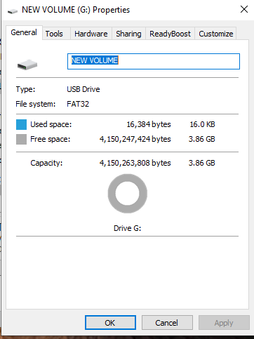

I’ve also attached a screenshot of what the CF properties are.

I removed the CF multireader and inserted a USB stick and it seems to be installing. So why can windows see and access the CF card yet Netinstall fails?
Leon
ok you have to run netinstall as administrator :frowning: but it failed Cannot copy system files
ok you have to run netinstall as administrator :frowning: but it failed Cannot copy system files ok looks lilke you can’t do anything while it is working
