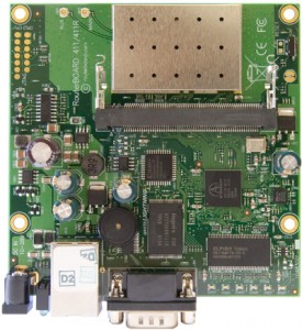

It looks like there is no way to do netinstall on the new RB411R
and RB750, since both of them don’t have Serial Port, right?
in the picture RB411R have serial port
which picture? no it doesn’t. wait for the newsletter
this one
it’s not the RB411R
So Normis, what about netinstall? :slight_smile:
