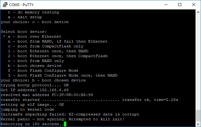

I have a problem with Mikrotik RB1100
I try Netisntall always appear
Kernel panic - not syncing: Attempted to kill init!
What can I do.?
Thanks, ![]()
What can I do.?
Thanks, ![]()
Use another version of netinstall …
Make sure that no other device is in the same physical network during netinstalling (read: use direst ethernet connection between PC and RB) and make sure you follow all instructions from netinstall manual … which is vital as netinstall procedure is fairly fragile.
