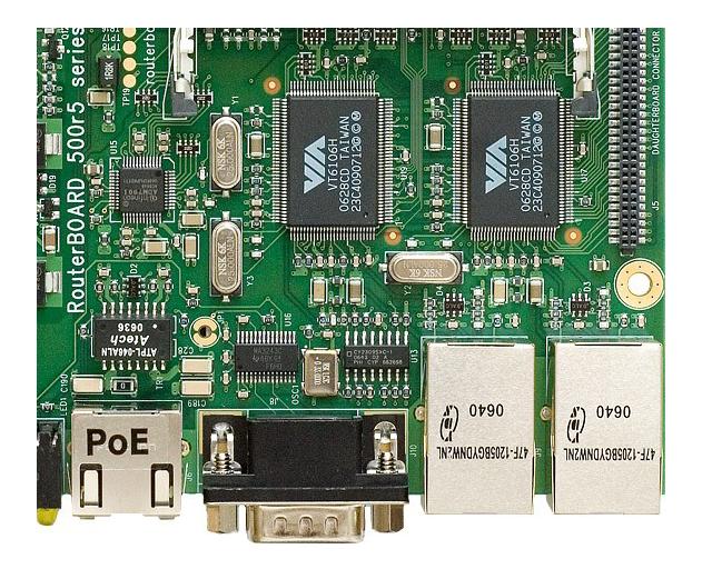

it`s got dead in a lightning, I use a POE but the power adapter does not have a grounded power cord
it is still working with POE but there is no link in the ether1 port
The same was happen to me some time ago - exactly in the same situation.
The VIA VT6106h LAN controller is probably damaged (in RB532 are 2 controllers - first behind RS232 and second behind ether2) - in my situation the damaged one is heating and routerboard resets itself every 2-5minutes.
Does anyone tried (or anyone can tell me) if I buy new vt6106h chip and mount it on the RB (I’ve solder skills :slight_smile: ) …will ethernet port works again ?
bump
Any ideas to do this?
Does anyone tried (or anyone can tell me) if I buy new vt6106h chip and mount it on the RB (I’ve solder skills > :slight_smile: > ) …will ethernet port works again ?
[quote=“pampi”]
[/quote]
in rb532a ether1 = ADM7001
ether2 & 3 = vt6106h
