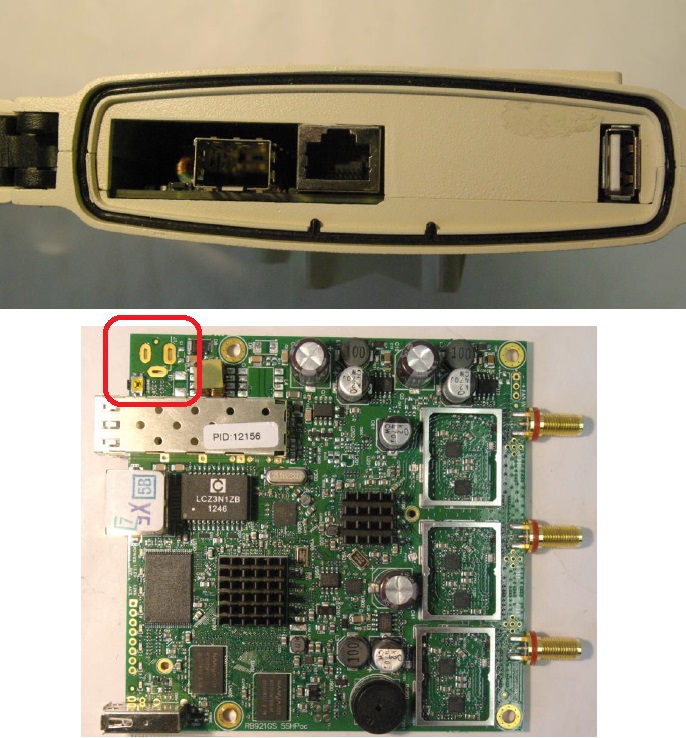

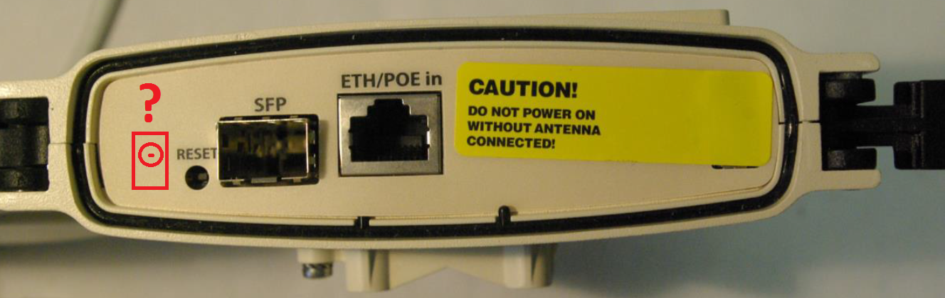

Can anyone logically explain why NetMETAL5 will be without the DC IN connector?
When someone wants to use the SFP it will not use POE
and then the DC connector is required.
Use twisted pair to power the device exposes unnecessary damage the LAN port.
Maybe You should remove sticker?! :stuck_out_tongue_winking_eye:
It may be exist version with and without jack

There are 2versions rb922GS
  1. with rp-rsma connectors and without jack
  2. with mmcx connector and with jack
    http://forum.mikrotik.com/t/news-about-new-products-is-secret-or-when-sxtg-5hacd-comes/78823/1
OK but this is fiber product (SFP fiber connection)
If there were no SFP, then the lack of the DC is OK.
However, in the case of the use of the fiber why do I have to use POE?
The LAN port is very susceptible to surges.
The use of fiber optic and dedicated power cable with DC jack solves all problems.

Soldering the DC especially, that RB is under prepared for it is not a big expense, and thus the device will be more versatile.
As for me netmetal after adding that DC JACK input is the perfect product
