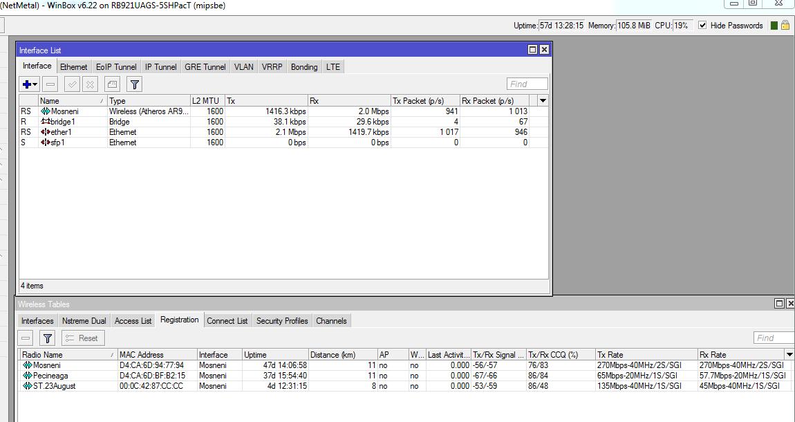

Netmetal are the best radios yet.
Look at the uptimes of stations and trafic in the evening is over 100mbps. All stations are N only.
So you have problems with the configuration.
Setting manual rates or power is never a good ideea.
NetMetal is connected to a ubnt 19dbi sector antenna.

Nothing special.
/interface wireless print detail
0 R name=“Mosneni” mtu=1500 mac-address=4C:5E:0C:86:27:DB arp=enabled
interface-type=Atheros AR9888 mode=ap-bridge ssid=“B_Mosneni”
frequency=5600 band=5ghz-onlyn channel-width=20/40mhz-Ce
scan-list=default wireless-protocol=nv2 vlan-mode=no-tag vlan-id=1
wds-mode=disabled wds-default-bridge=none wds-ignore-ssid=no
bridge-mode=enabled default-authentication=yes default-forwarding=yes
default-ap-tx-limit=0 default-client-tx-limit=0 hide-ssid=no
security-profile=default compression=no
