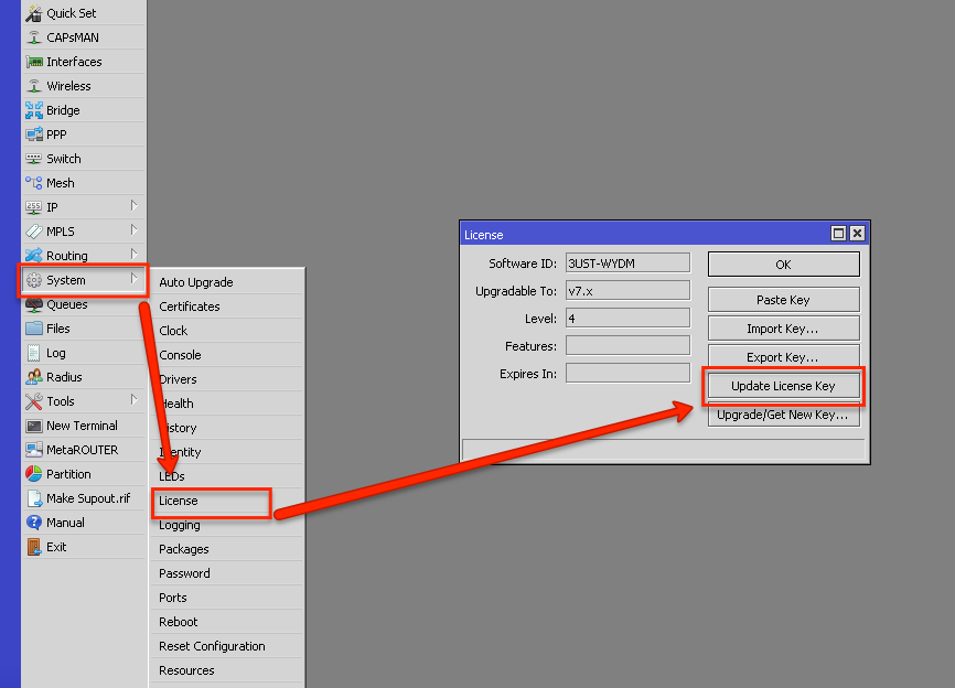

InoX, we are sorry for the inconvenience caused by this issue. It is very easy to get level4 on your router.
Access your router by Winbox, open System —> License and click “Update License Key”.
Instructions are available at the attachment.

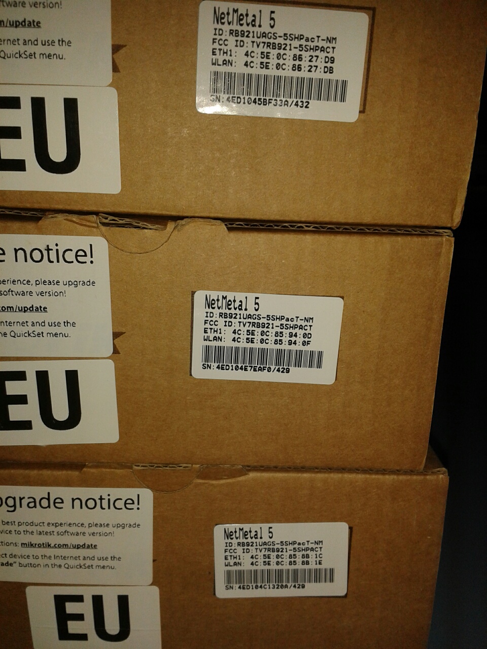

Two serials 4ED104C1320A and 4ED104E7EAF0 came with level3, we will fix keys for them and “Update License Key” should work after it.
4ED1045BF33A, this one comes with level4. Make sure you have switched it on and checked that level4 is available.

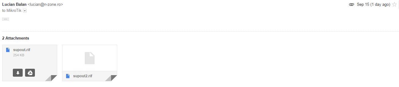

I’ve sent the supout.rif to support.
We have not received support output file, but applied few fixes to our acconting server.
