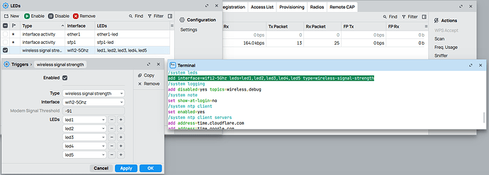

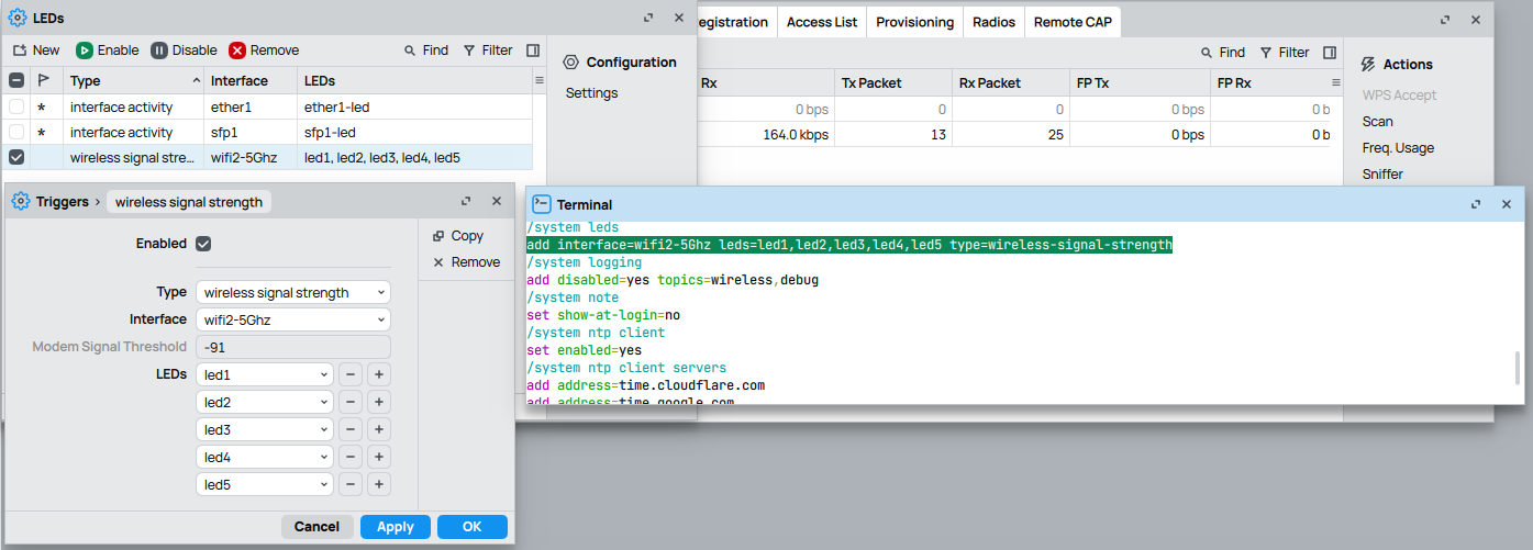

I now have a device with wifi-qcom and I experience the same issue…
LEDs configured correctly but not working.
