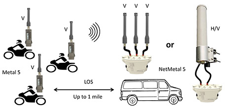

Dear All,
I need to establish links to 2-3 moving targets equipped with Metal 5 radios @ 3-5 Mbps speeds. (no more than 3 clients)
I understand advantages of MIMO with H/V antennas but in my case, all clients are V-only Metal 5 radios.
My priority is link stability over speed.
Should I use two V sector antennas with dual-chain NetMetal or dual-polarized H/V sector antenna?
What advantage from using H/V if all clients are V-only?
Does NetMetal support diversity antennas? (spatial)
Similar question about mobile “command and control” van:
Should I use triple-chain NetMetal with three V-omni antennas or dual-chain with H/V omni?
Please, advise.
Thank you.

Due to design specifics, I would have to use Metal 5 radios with V-pol antennas.
So, what’s the deal with NetMetals? Can I connect multiple V-pol antennas for diversity?
