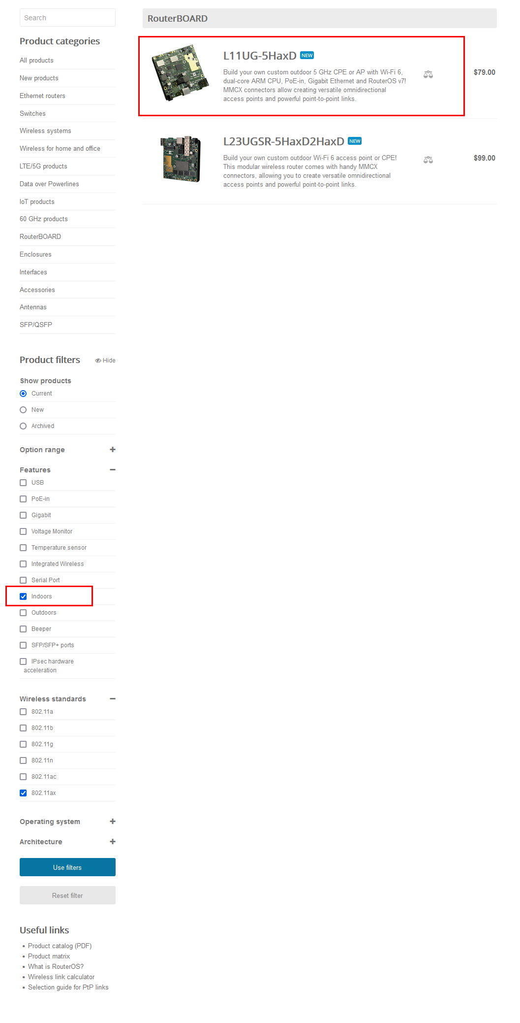

I agree, the TX-Powers are somewhat random and the regulatory information does not match the reality on the device. I recently bought a new L11UG-5HaxD Routerboard, for building a custom indoor solution and this one skips the lower frequency channels 36-68 in the ETSI region (Europe). So i opened a ticket and they say this device is an “outdoor only device” and is by design so the indoor channels are disabled by default, mööööp, no information about this anywhere on the product or manual pages :face_vomiting: . Choosing other countries outside the ETSI region give me also a max of 16db, but in Germany we have a max of 23db(200mW) in the lower channels so i cannot max out the range with a 3dB Omni. Upper channels in Germany allow up to 1W and the board sticks at 22db on these channels.
