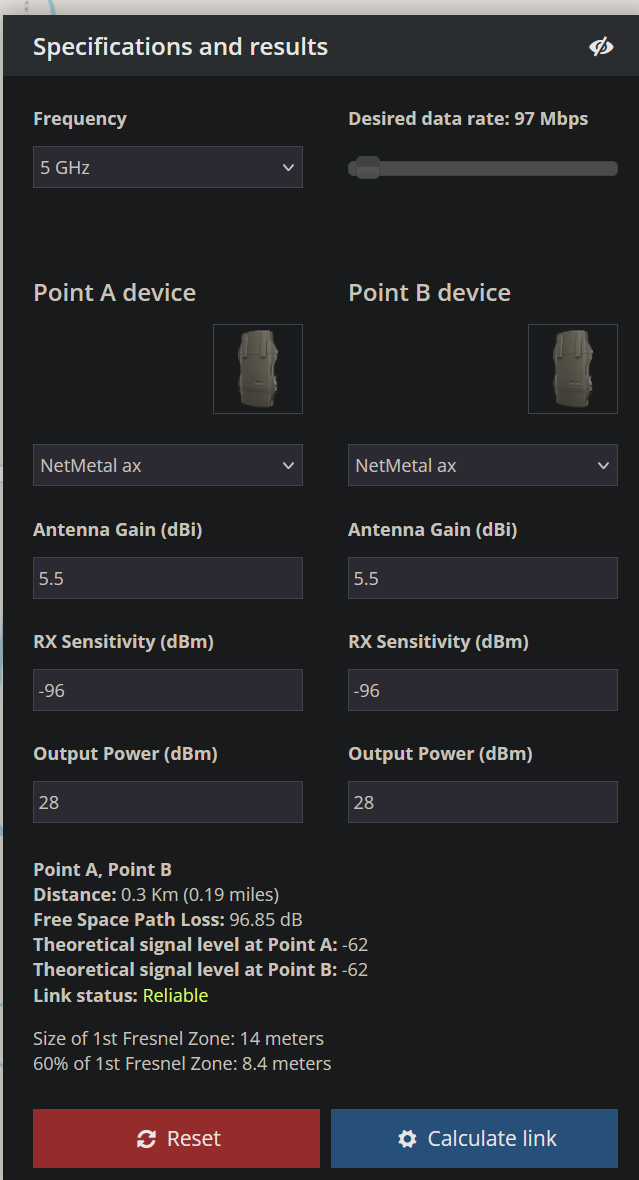

Mikrotiks own calculator @MCS0 says the same tbh
There’s one big problem with settings: unless you try real hard, country regulations regarding Tx power will kick in. On 5GHz different channels have different limits, e.g. in ETSI countries 5170-5330MHz allow 23dBm, 5490-5730 allow 30dBm and 5730-5875 allow only 14dBm. And that’s EIRP … substract antenna gain as set by configuration/antenna-gain (on NetMetal it’s probably 0).
The calculator on screenshot is configured for 33.5 dBm of EIRP. And already mentions Fresnel zone … which has to be clear entirely to achieve full signal strength. If you look along the link (LoS), Fresnel zone is a circle around it with diameter indicated (14 meters) … so radius of 7 meters around direct line. The size indicated is at half way between both points and gets smaller closer to either end point. More on Fresnel Zone on Fresnel Zone calculator.
