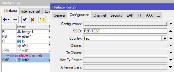

I’m using a MikroTik NetMetal AX (L23UGSR-5HaxD2HaxD) with RouterOS v7.19.1 and the wifi2 driver, and I’m facing the following two issues:
1-No Available 5GHz Channels
I’m trying to set up a point-to-point (PTP) link using 5745 MHz or 5500 MHz, but receive:
# no available channels
#My setup:
Interface:* wifi2
RouterOS:* 7.19.1
Country:* Iraq (also tested with united states)
Mode:* AP

Sorry it was typo issue,
Country is Iraq, dfs is disabled, and wifi1 is 2.4, wifi2 is 5 Ghz
Netmetal is outdoor device.
Probably not all 5ghz channels are allowed ?
My mistake on wifi1/2.

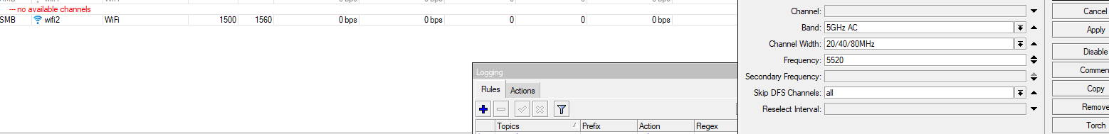

The frequencies are available for outdoor in both countries, but they are dfs.

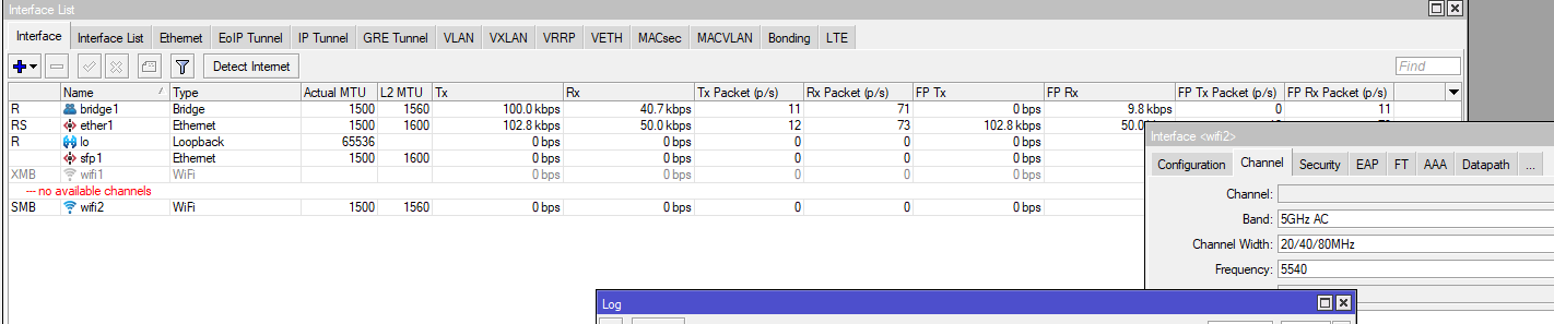

Maybe the frequency is unavailable because of dfs? This should show up in the logs. Maybe enable wireless debug messages?
no most shows that
in debug shows below
and also show this in wifi2
That makes sense. 5520 is a dfs channel, and you selected to skip them.
Anyway, return to defaults, even reset the device to default. Make your changes one by one and see which one causes the conflict in your config
for now i made it allm i returned back to disabled see below
Basically you are saying: don’t use DFS channels…use frequency 5520 (which is a DFS channel). What are you expecting!?
Leave frequency empty to get it to work, or set consistent settings. If left empty you will see what frequency the device chooses (I would expect a 2.4GHz channel frequency).

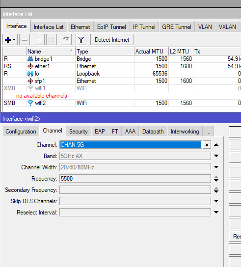

Can you change it to something like this:
/interface wifi channel
add band=5ghz-ax disabled=no frequency=5500 name=CHAN-5G width=20/40/80mhz
/interface wifi
set [ find default-name=wifi2 ] channel=CHAN-5G configuration.country=Iraq .mode=ap .ssid=P2P-TEST disabled=no

Same issue
/interface wifi
set [ find default-name=wifi2 ] channel=CHAN-5G configuration.chains=0,1 \
    .country=Iraq .distance=3 .mode=ap .ssid=P2P-TEST .tx-chains=0,1 disabled=\
    no
remove chains/tx-chains.
Chains for Anntenna not for Not Available Channels anyway i did and same result
Does it show a “DFS scan in progress” comment when you change any setting? To me it seems like 5500 is just not available and you only specified one frequency so it can’t select any other channel.
