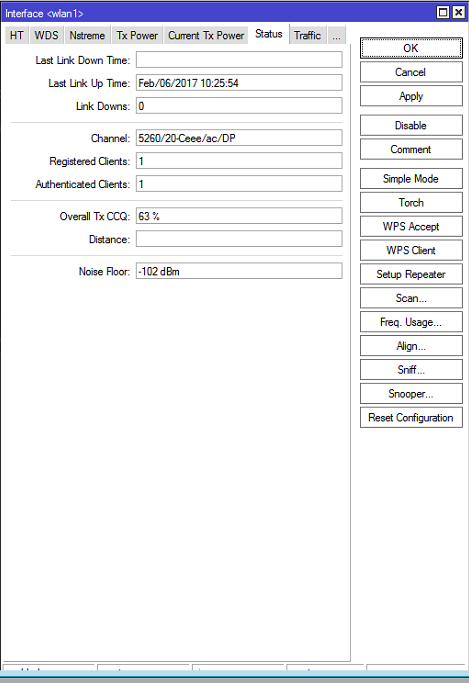

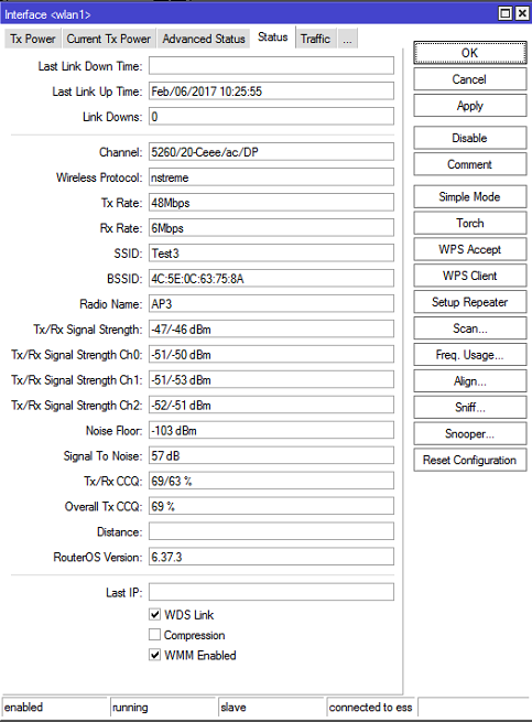

can you post screen shots of the status for each link. Any errors however small on the wireless side will affect throughput.
Thanks a lot for your fast reply…

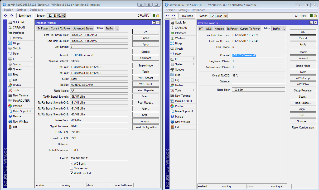

Here I attach the screenshot of the status page of devices.
And this is the other point-to-point.
I forgot to tell you that I’m using MIMO 3x3 using all the three chains available.
Any help or suggestion would be appreciated.
Looking at the first images you posted your ccq is a little low. you possible have some interference or you need to turn down your power on your TX. have you tried different wireless protocols.

@dgnevans: forget about the first link (it was under installation with no finalized setup-up), just consider the second one that was up and running.
@hengst: the max throughput without vlans that I’m able to reach is around 120Mbps of Ethernet frames (no TCP, not UDP with link capacity of 1.170/1.300Gbps). With TCP I’m not able to exceed 50Mbps. It seems that the processing of the packets is too CPU hungry… Why using a VLAN should solve my problem?

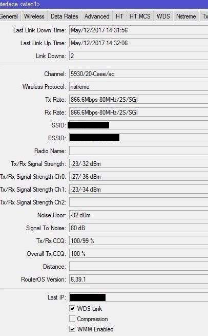

Here is my status, but I cant get over 220mb tcp traffic. using nstreme also.
