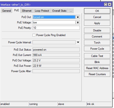

If you have both types of PSU purchased and connected at the same time, the device will automatically sense and detect if the HI or LOW voltage adapter must be used. Or you can set it manually, per port.

Currently there are only 2 available devices with voltage conversation on board using single power supply - CRS328-24P-4S+RM and CRS354-48P-4S+2Q+RM.
For other devices it is like “what you give is what you get”, therefore, as example, if you will use 24V to power the device, then on poe-out ports you will have 24V ( - possible voltage drop due to cable length, quality etc.)
