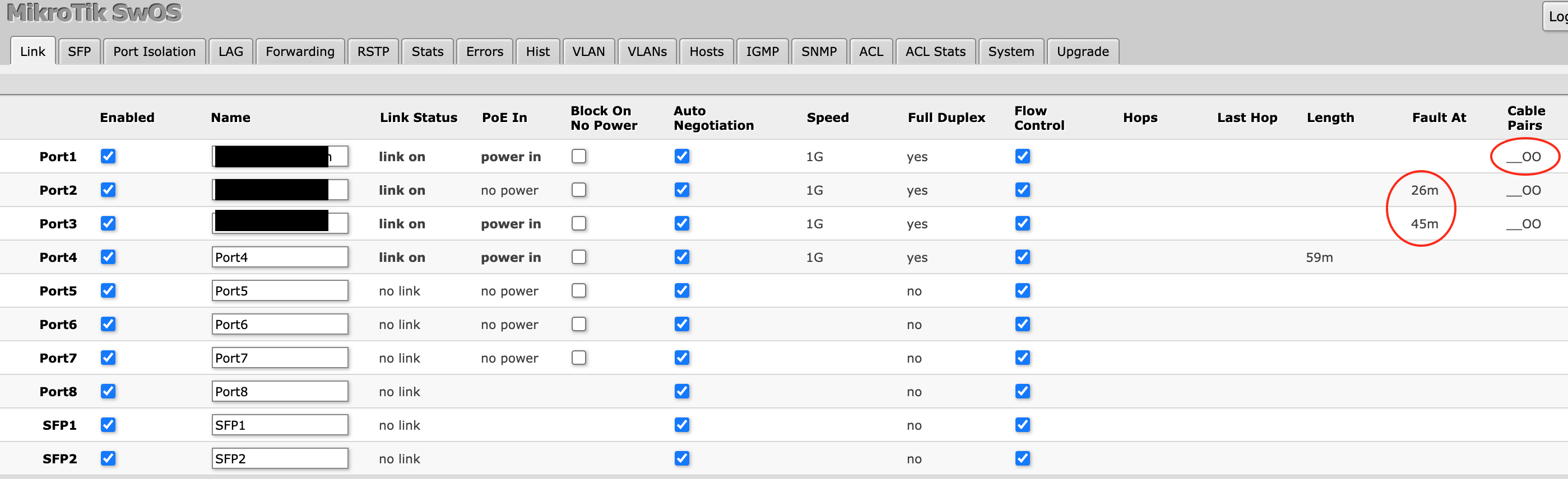

I can’t find any documentation as to what exactly the “Cable Pairs” field in the Link tab means. We have 2 7R working fine for us but show “interesting” messages.
Show faults in the cables as well but seems that all work fine, cables have been tested. So is that a software error ?
Interestingly the last cable installed today do not show fault and show distance.
Also one of the 7R is powered out of an OmniTik POE 5 ac, (on port 1) and show cable pairs __00. The other is powered by a poe injector and show ___P . Trying to understand what all that mean.
Thank you.
Olivier
Its very likely a software bug. If everything is working, I wouldnt read much into it. The firmware is still in BETA and currently at 2.13RC12. DL link is towards bottom of this thread incase you’re interested. But if everything is working, I would just wait until a stable is released
