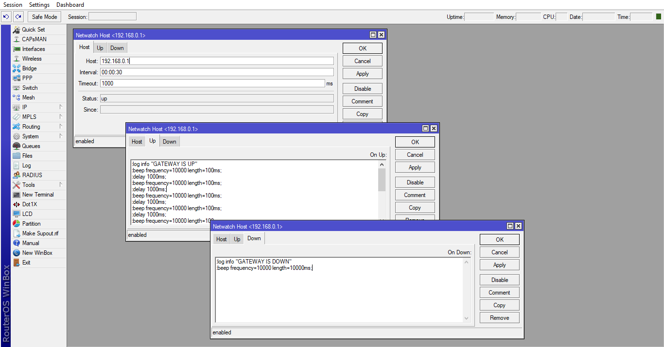

Ok. In that case you can just do what you originally intended. Just paste the script from the first part of your first post into the Down tab.
This is my simple netwatch setup if my gateway is down or up
I hope I helped
