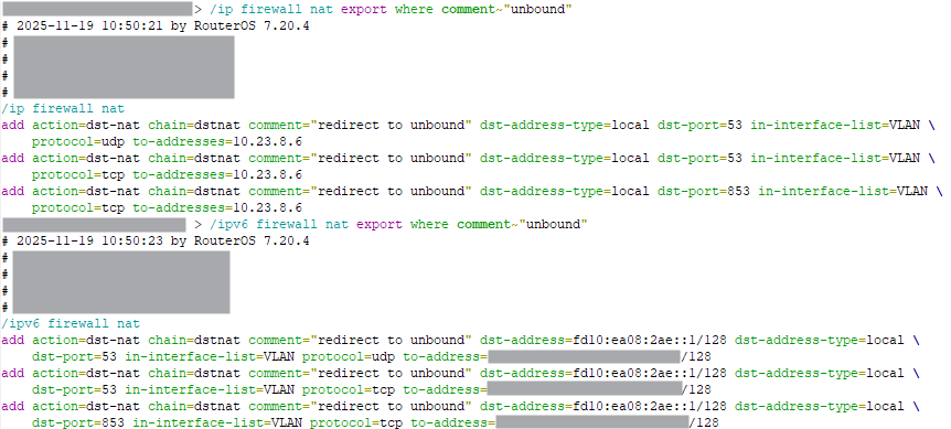

  1. Is to not use the MikroTik DNS server but still have DHCP / IPv6 RA pointing DNS to the router's IP addresses (for IPv6 preferably to an ULA address, not the link local fe80 address). But then have DSTNAT rules redirecting everything to AGH. Then the script trigged by Netwatch only changes the value of to-addresses/to-address of the rules.
DSTNAT rules on my home router:
