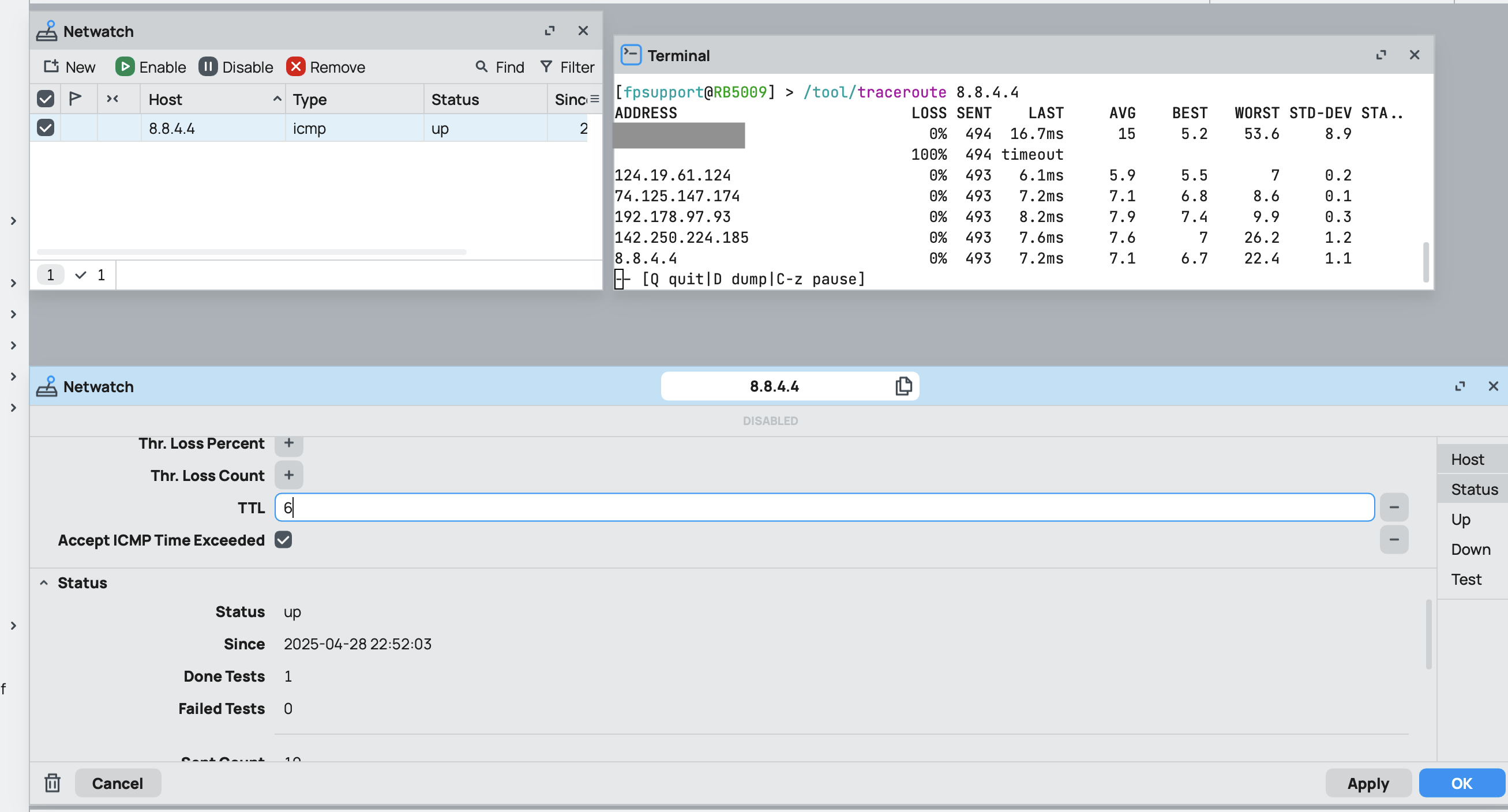

I am testing the Netwatch TTL / Accept ICMP Time Exceeded option and don’t quite understand why, when pinging 8.8.4.4 (as an example), a TTL of 3 passes but a TTL of 4 fails the test.
The traceroute shows 7 hops, a Netwatch TTL of 3 results in an UP state:

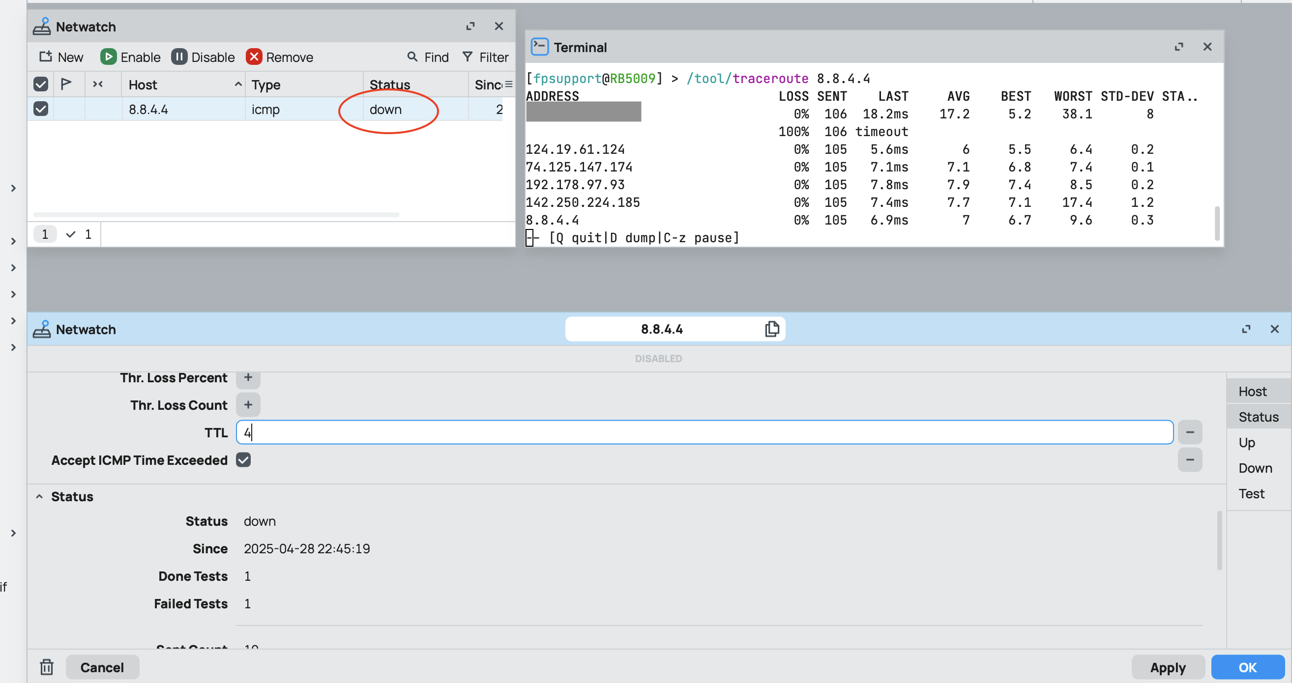

Why does a Netwatch TTL of 4 cause a fail?

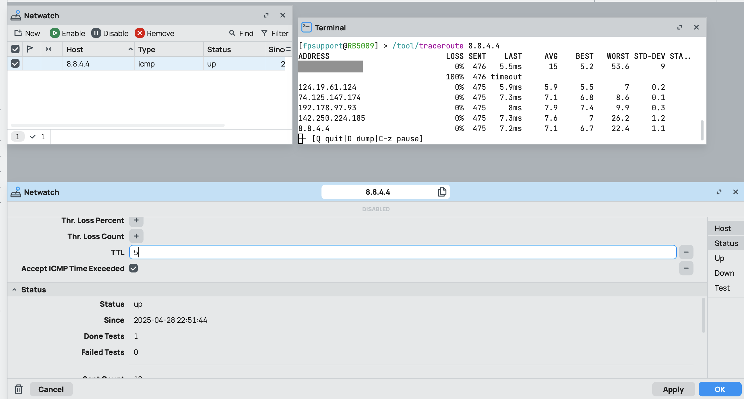

And TTL’s of 5 and 6 pass as well. Why does a TTL of 4 fail???

I still don’t understand why a netwatch TTL of 4 fails. Remember, “Accept ICMP Time Exceeded” is enabled in the netwatch test. TTL of 4 should pass the test.
More netwatch bugs?

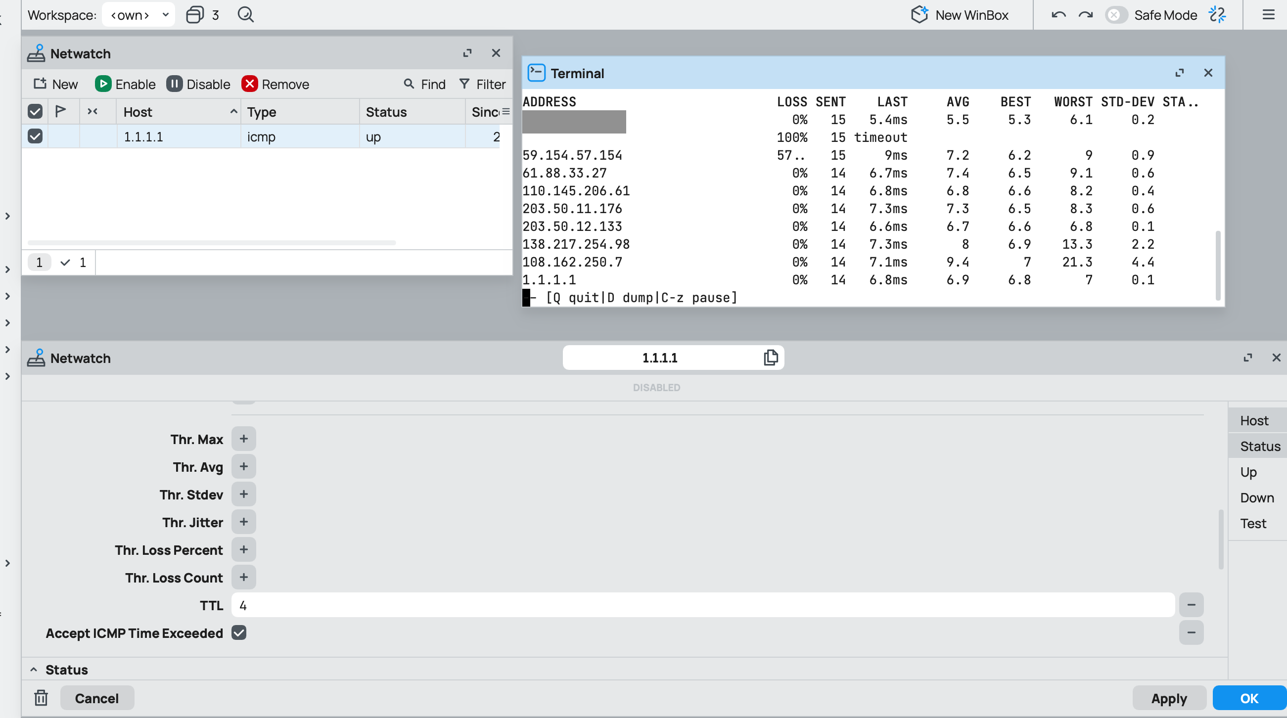

A TTL of 4 works against 1.1.1.1 with the same #2 hop timeout:
