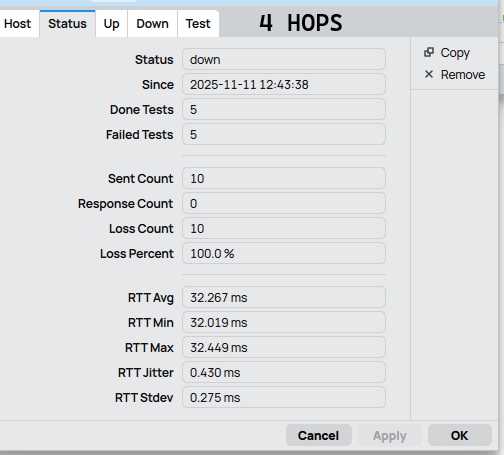

Curious about this function if ICMP probe,

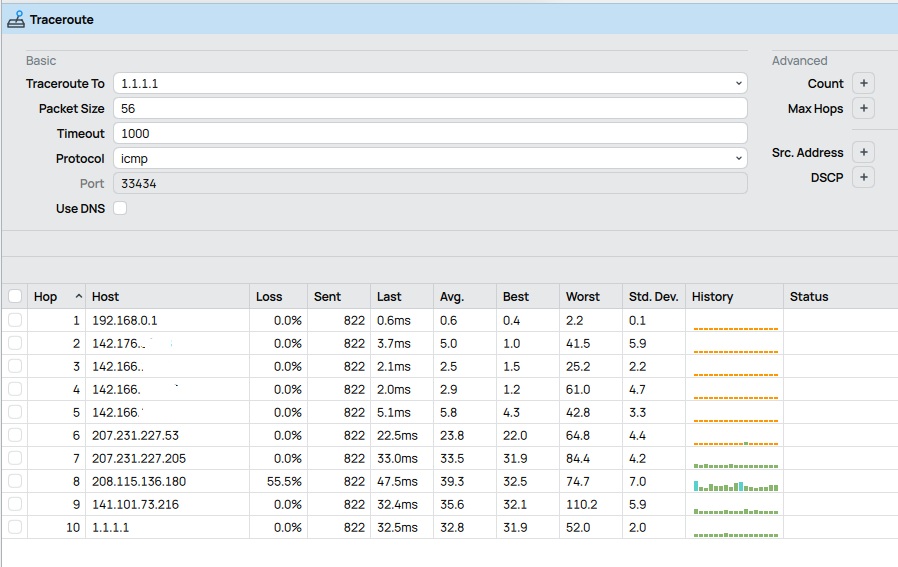

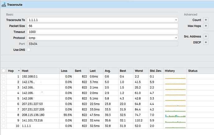

I setup my natted router and tracerouted to 1.1.1.1, the first hop being the Main router of course.
I figured on 7 hops would get me to the internet but not quite reach Cloudflare.

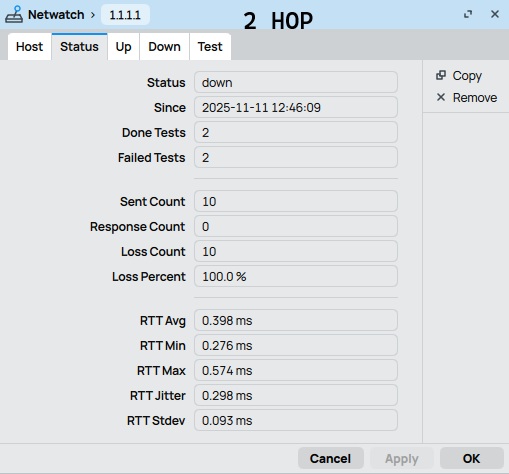

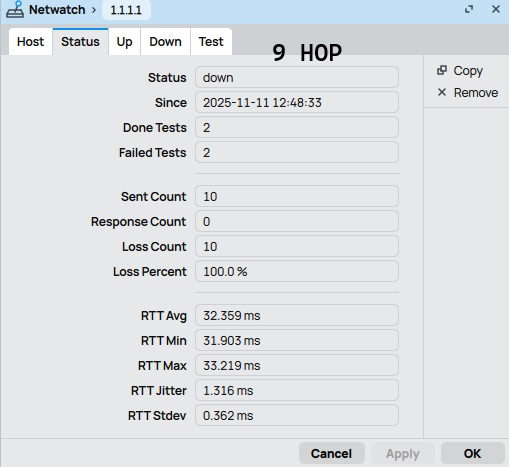

So I did 7 hop TTL on the rule and the interface came back as DOWN

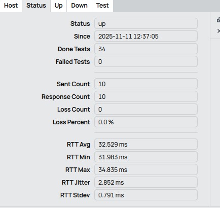

So I did 12 hop TTL and the interface came back as UP.
So I can confirm there is some information there to be gleaned but I think something is not right.

Can you try to set ttl=30 ?
To what end, when I used 12, aka reached the host entered 1.1.1.1, the interface came UP.
If I enable "accept icmp time exceeded", with a small TTL (4), I get status is UP.
Can see the icmp time exceeded packets coming back.
Seems quite useful.
I get status down if something fails prior to 4 hops away. When no icmp is returned
I assume it might also be down if was getting icmp destination unreachable back.
(It likely ignores all except time exceeded)

Okay Jacklaz I will bite, I was leaning towards, useless because I get down for setting of 1 hop, I have reached my main router from my natted router (USELESS), I get down for two, (I have reached my ISP first local address), I get down for 3 hop ( I have reached my ISP local second address ), I get down for 4 hop ( I have reached an out of 'state' ISP address), I get down for 5 hop ( My ISP in yet a different province ),
I added hops until I reached 1.1.1.1 and then the probe came back as UP. So if there is no clear cut distinction between any of the DOWNS prior to reaching the canary itself, the functionality is useless.

Here is my traceroute and my results of each status.............
Note: Based on traceroute results it appears that the www is only reached for sure when solid green is returned????????? aka hop 7
Followed by ping 2, 4, 9 (all down) and then 10 ( up ) reaches canary.
