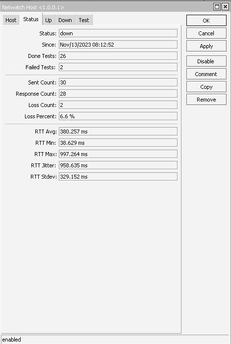

still triggering down and I have the thr. avg at 600.00 ms..
I dont understand :frowning:

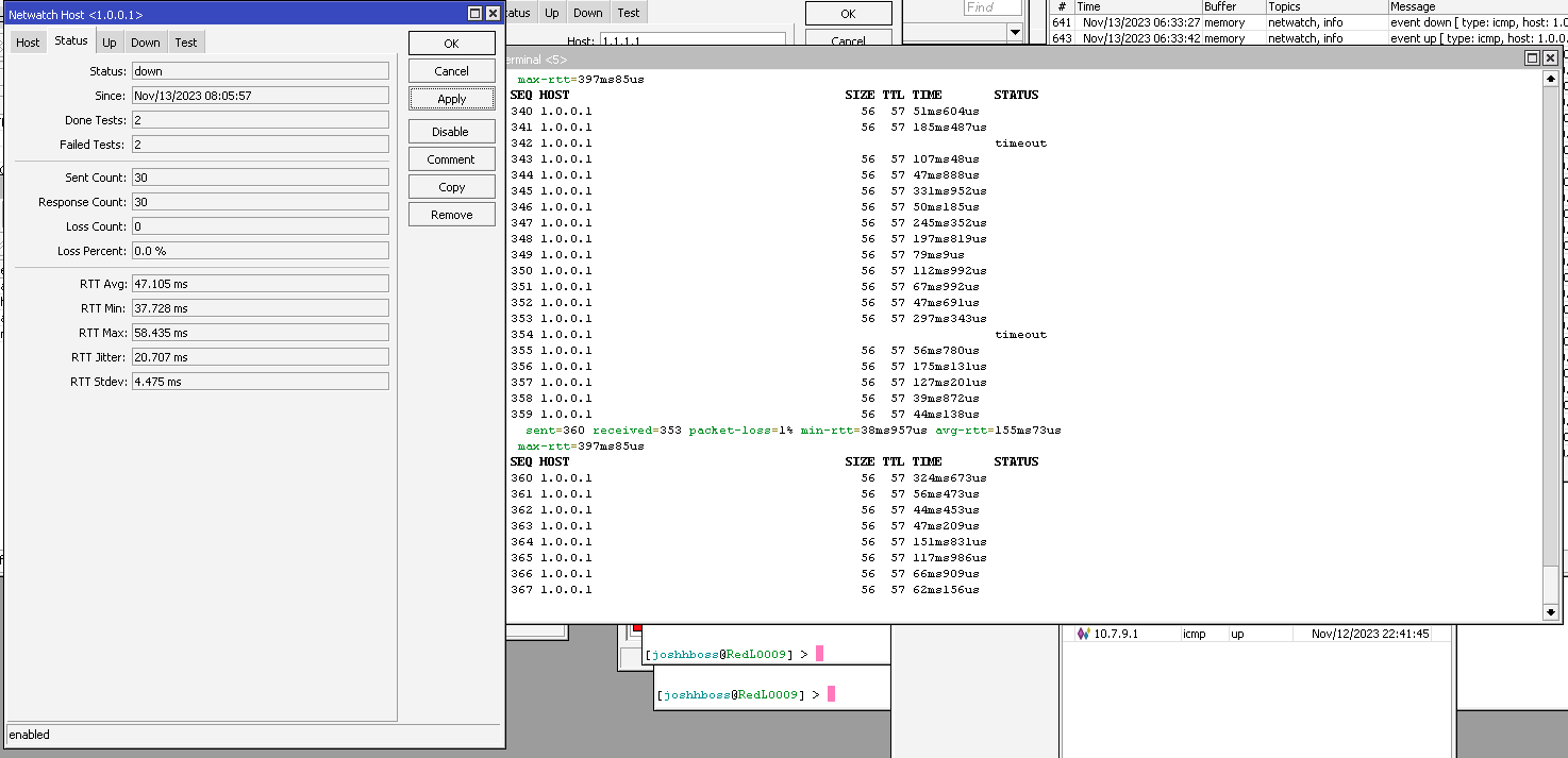

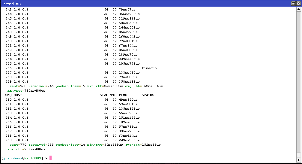

Now here is one that is a failure along with how the ping looks from the terminal, is ping from the terminal now a safe way to gauge how to configure netwatch ?

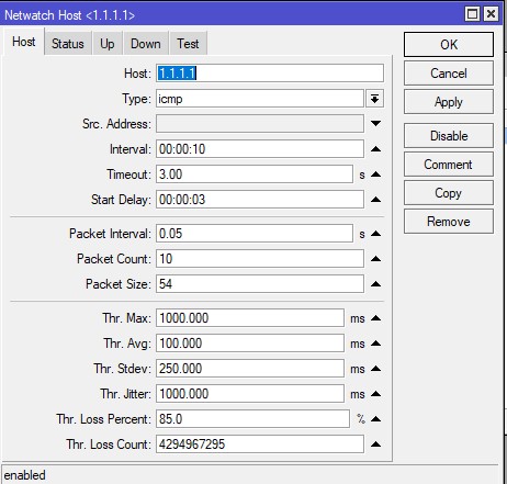

You didn’t show what kind of sills you installed.
It will be triggered when any threshold is reached.
If you claim to have observed an average ping of 600ms, you can set such thresholds.
Then the main indicator will be 85% packet loss. If false alarms continue, increase the thresholds further.
On the last screenshot above the standard deviation parameter was triggered, the threshold was 250 on the screenshot 329.
I tried those values, thank you again for engaging, been battling this for a few weeks now, im already seeing a massive improvement. now I feel better on how I should play around with this more.
