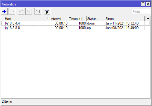

I am in an issue and not being able to find out what am I doing wrong. I follow step by step the follwing link: https://mum.mikrotik.com/presentations/TH18/presentation_5725_1534743837.pdf to keep my home Mikrotik running with both ISP providers I have (VIVO and TIM).
It was working fine until I lost connectivity through TIM due to a fiber rupture on street and since them interface show as down at Netwatch. Some wirdeness:

Therefore keeping at netwatch interface down. I am adding the config and Netwatch screen at this thread. Any tip is very welcome!
myconfig.rsc (5.7 KB)
What is especially weird is that traceroute to 8.8.4.4. works via the correct gateway but ping doesn’t.

jan/26/2021 17:28:47 system,error,critical router rebooted without proper shutdown, probably power outage
Then after some time it come back. I am not able to find where I can add the file here.
When you edit a post, below the editing window there are buttons [Save draft][Preview][Submit], and below these, there are two tabs: (Options) and (Attachments). Click (Attachments), there is some explanation and a button [Add files]. Some people report problems to upload files due to low karma or so, can’t test myself, for me it works. If it doesn’t for you (and only if it doesn’t), place the file somewhere at a generic, login-free file sharing service and place a link to it here.
