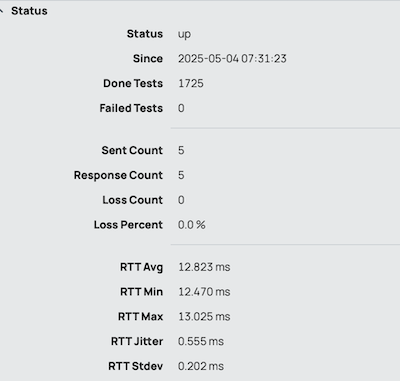

I re-read docs this AM.
The docs are incomplete(/wrong) on the values used in a netwatch script AFTER a test are not thr-* — rather rtt-. You can you see these values in the “Status” section & if logging the RESULTS of a test you want to use rtt- like rtt-max/min/stddev/etc. More specifically $“rtt-max”, since variable has special character (-). The thr-* are the spec/requirement that DEFINE what success is, not the result.
For example, if this is used in up-script= or down-script:
:log info "NETWATCH host=$host status=$status comment=$comment interval=$interval rtt-avg=$"rtt-avg" rtt-min=$"rtt-min" rtt-max=$"rtt-max" rtt-stdev=$"rtt-stdev" rtt-jitter=$"rtt-jitter" "
you get a log entry if status changes:
NETWATCH host=8.8.8.8 status=up comment= interval=1000 rtt-avg=12769 rtt-min=12406 rtt-max=12995 rtt-stdev=200 rtt-jitter=589
Filed a doc bug about this (SUP-187116)… since docs should mention the rtt- values.

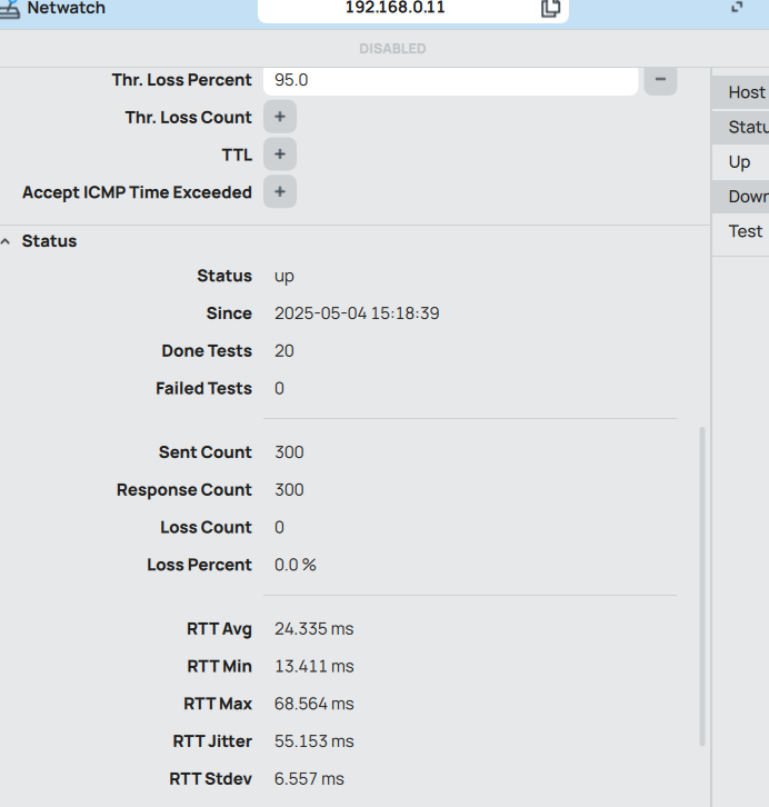

The variable names match winbox, except the name is all lowercase, and any spaces become a dash (-):
As noted, both here and docs, if it contains a - (or space as shown in winbox), then you need to use $“first-second” in any scripts.
It should be in the docs is the issue.
I do indeed see:
But I would never have figured out with your help that the system has predefined variables matching what is displayed (and that is not considering the inclusion of a “-” or the need for $“”)
How would one find this out? I suspect there are plenty of other areas of ROS where predefined variable exist.
