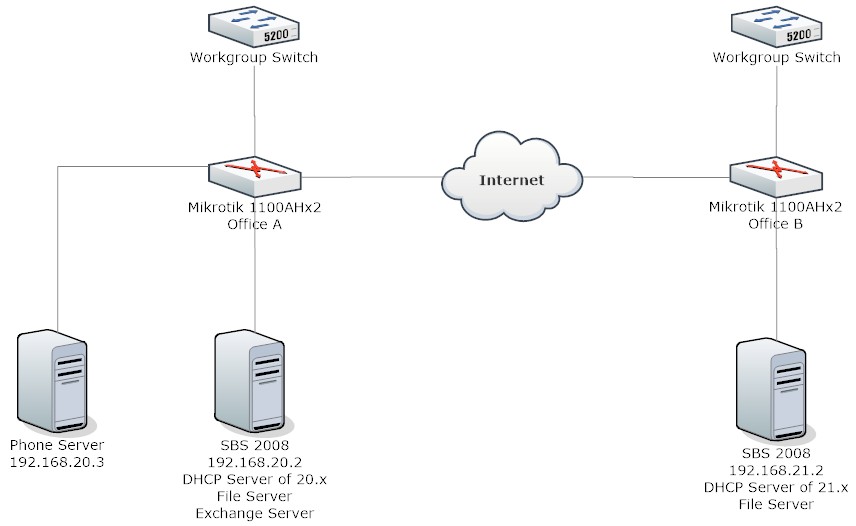

Hola,
I recently purchased a few RB1100ahx2’s and did the upgrade 6.7 fw upgrade and I am having a buggar of a time trying to connect rb to an exsisting network. Here is what I have. I have 2 offices office A and office B. They are currently running Cisco RV042’s and using IPSec and currently working. Last night I went to office A and tried to get the mikrotik to connect to the Cisco. Which did seem to work for awhile… but it had odd drops and such. One minute I could ping the gateway at office B from office A then i wouldn’t be able to. However I always had connectivity from office B to office A just not always the other way around… and by connectivity I mean ping.
I had alot of odd issues. At office A I have a SBS 2008 server with an Exchange Server and a Shortel VOIP server and it would work half the time then other times it would just stop. I am assuming I may have garbled some of the IPSec settings up or maybe I need to allow some sort of firewall rules. As of now that rb is in the closet and I wont have access to it for a week (I should have exported all the data sorry)
My end goal here is to take the RB1100ahx2’s and use IPsec to connect both offices. I love these mikrotiks and have been trying to learn more about them.
Attached is my end goal. Anyone who could lead me in the right direction, Id be very grateful!

I’d setup an EOIP tunnel and then encrypt it with IPSec. The EOIP tunnel should keep the IPSec link alive for you.

That is my ideal outcome with the two mikrotiks. See the offices are far away and I cant have them down for that long as I as the transition. Both of them at the moment are using the Cisco’s. I would like to use one mikrotik to connect to the cisco as it buys me time to drive to the other location to swap the last one out. It’s not something I can do all in one day.
Ideas?

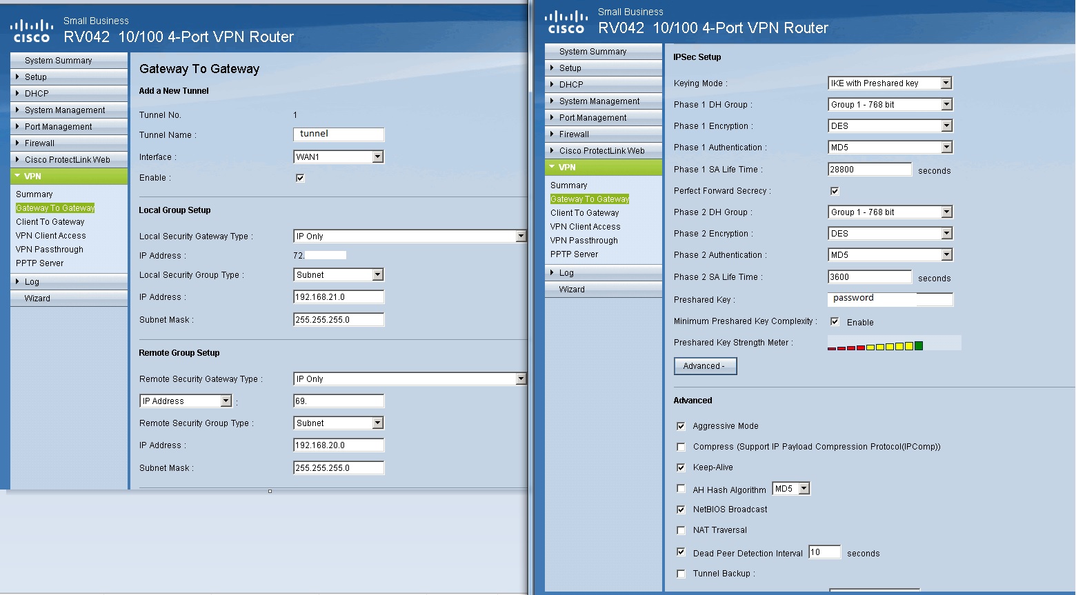

Attached is the setup I need the Mikrotik to connect to. Ideas on how to do it and make it work? Perhaps I screwed it up.
I tried to follow this example http://wiki.mikrotik.com/wiki/MikroTik_router_to_CISCO_PIX_Firewall_IPSEC

Alright.. post your config from your mikrotik?

I’m going to have to wrap my head around all of that. Your firewall seems slightly confusing to me… you also have a bunch of dst-nat stuff that isn’t necessary.
So you said it connects, but no traffic goes across? or what is the exact behavior? Do you see SA’s installed (IP → IPSec → Installed SAs)?
-Eric

efaden:
-Eric
Actually there is alot of firewall rules that were dupped. It was some old fw rules my buddy was toying with.
I know I have some dst rules that dont need i just dont know which yet.
Yes I see 2 SA keys installed
When I first started the router and went into IPSec I noticed that I didnt have exchange mode set to aggressive like I did in the LinkSYS. So I changed that. I then went to IPSec, Proposals and checked all the AUTH Algo.'s
As for now it seems to be working. The phone system works from here to the other office. The emails seem to be sending.
Although I could use some drastic help w/ the firewall as mentioned lol. Basically, I just want to protect this network the best I can.

Also, the Mirotik just stopped pinging the attached network that runs through the IPSec. I still see installed SA’s but I cant get to the other side. Now the phone wont dial out to the other office.
efaden
February 3, 2014, 11:34pm
17
Odd… At some point what I would do is just set it up to use IPIP/GRE/EOIP over IPSec… they are stateless and will generally keep the link alive. Also you may want to upgrade to 6.9… there are some issues with the lower v6 and IPSec.
ProCon
February 3, 2014, 11:36pm
18
Interesting. I flushed the SA’s and BAM it came back online… what the heck does that mean?
I would like to change to something for stable for sure!
efaden
February 3, 2014, 11:39pm
19
Not sure entirely what that means… Do both sides have the same lifetimes set?..
ProCon
February 3, 2014, 11:57pm
20
Yes they do now. Phase 2 timer was set different. I put them all to the same now. There seems to be a heck of alot more Installed SA’s now after this update. Is that normal?
