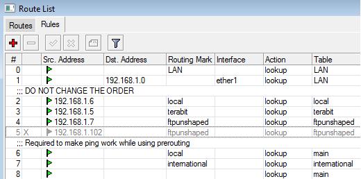

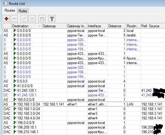

The RB is also used to separate local and international traffic and use different routes for each. I have attached jpgs of the route list rules.

Look at your second screenshot, specially to selected route. You really need it? 192.168.1.0/24 is not
connected to your board (DAC just after selected one)? And… you are routing 192.186.1.0/24 through 2 interfaces? ether1 and eth… Maybe that’s the point, when mikrotik use a wrong interface you cannot reach right destination.
I saw the LAN routing mark, but don’t got why you use that.

Thanks for the reply! I also saw that, but the 2nd part of “ether1, eth…” is also ether1. It’s just a route I added for the routing mark LAN. It was an attempt from my side to fix the problem. But clearly it isn’t helping much. I can’t modify the “ether1, ether1” field… it’s automatically populated for me.
