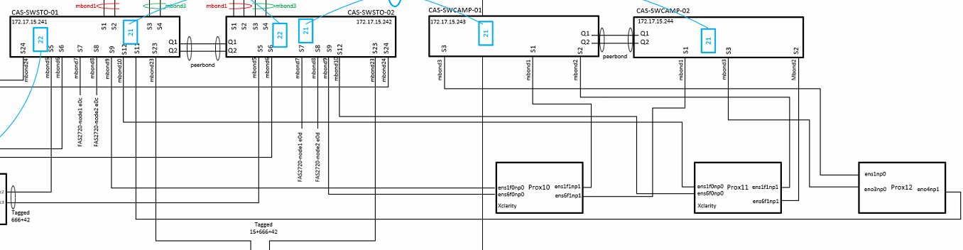

Could you come up with a network diagram similar to this?, so that others can help you triage the issue?
If that can help
an exemple of a bond configuration :

@babine , on your diagram it looks like each proxmox host has a lag to 2 different switches. Is it how it is connected?
Each host with 4 10GB ports
Each host has two 2-port aggregates
One for NFS storage access, the other for VM networks
all aggregates are LACP , hash 2+3
On the mikrotik switch side, I have 4.
2 times 2 switch in MLAG. 1 MLAG for NFS storage and another for VM networks.
everything works perfectly. I’ve just noticed these problems when rebooting.
I’ve never had this kind of problem with Cisco Nexus and VMWare.
Yes, I have VLANs on my infra.

In the diagram, prox10 has a bond ens1f0np0/ens6f0np0 going to swsto-01 and swsto-02. Can you confirm this is the case?
Because that might not work the way you think it does.

Unless the 2 switches are stacked, this is not going to work: all the links in a bond must go to the same switch.
Can you configure that and try again?
They are stacked . I have created a MLAG
Taking the time for a proper response.
Lacp rate is 30 secs, can you set something lower? Doc recommends 1 sec
Stp -
Is the prio and costs the same on both switches in each pair?
Can you set the ports as edge, if there is no risk of a loop?
STP - I compared the settings on my two bridges and found a disparity. One of my bridges had the port cost mode in short instead of long. This has been corrected.
I changed the LACP rate as requested to 1s on all my bondings.
I’m going to run more tests with these changes to try and reproduce the problem
Hi there! Did it solve the issue?
Hey,
I wasn’t able to reproduce again the issue. So I guess we can say yes !
