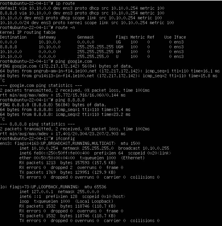

Just adding the screenshot in the client:

this can't work. this is the network address. not allowed as IP address. But I do not understand what your issue actually is or what you try to achieve by this experiment. I also do not understand what "navegation" means in the context.
I know it sounds weird, but on RouterOS works... (ignoring all the consequences)
Yes, i know that, what i mean is: this cannot happen because is reserved IPs, but ok… And… Yes, i know about subnetting, like in a /23 have 512 possible ips, and .0 and 255 can be used, but what i want to say is like you said: it weird, and for some beginners this may be confusing and issues can appear in some nets
So… One last thing… When i say “navigation”, i mean to say: access internet, resolve names, and all that… I’m sorry for that, force of habit…
I know that… I know this is network ip… And is exactly what i want to say… This cannot work, but its working
